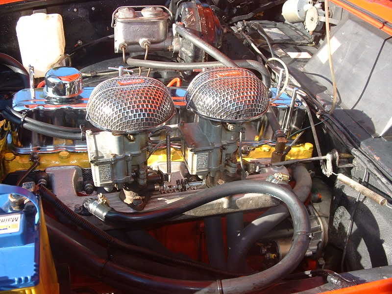

Thought id drag this post back up again to let you all know that the Lc 2-door has now had for the past month or so had a set of twin strommberg carbys running on a X2 manifold with the manifold cooling and running the original style throttle linkage/ kickdown setup, just with the linkage from the firwall to carby cut and shut...all runs pretty sweet but it idles at pretty high rpm because i need to muck about with the return spring setup and carbys a bit more to get it spot on...anyway all said it gets along pretty well now and has surprised its fair share of rice burners!
I'll post some pics over the weekend to give you guys a peak

Makes a change from triples. Very cool thou

looking good mate.

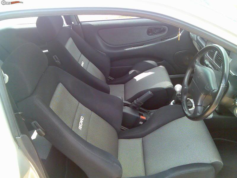

selling of the four door means ive got a bit of cash to blow on the two door, after much consideration ive decided that im going to try to find myself a set of recaro bucket seats, after hours of research and browsing ricer forums such as nissansilvia.com and boostcruising.com ive managed to settle on what im looking for, even though i think ive been permanently scared by the experience. I think we should all be thankfull how little BS is present on these forums after i spent a few days scouting through these other forums.
im trying to source a set of seats from a proton satria Gti they look like this...
they made the little rice boxes from 99-04 so finding a decent secondhand set shouldn't be to hard compared to finding secondhand parts for the torana.
