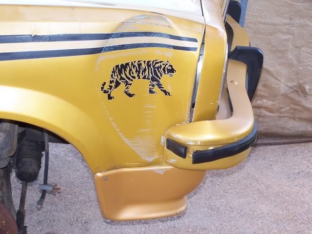

#23 _Brewster_
_Brewster_
Posted 03 July 2007 - 08:56 PM
Ok here goes, I'm working with Tim to get my uploading image issues sorted, thank you Tim! I've taken a few pics of the car in its current condition. Just so you guys can get a feel of what I'm working with.
The first pic is the actual damage of the car, dent int he panel and bent bumber bar. I was just gonna get this panel beated, any thoughts?

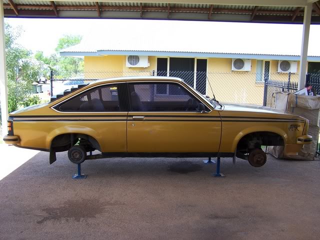

#24 _Brewster_
_Brewster_
Posted 03 July 2007 - 09:08 PM
Awesome, it worked, here's just the RH side profile of the car, other than the LH side, in the previous page :D You can just see it, but the paint has started to strip off the door, more about that later.

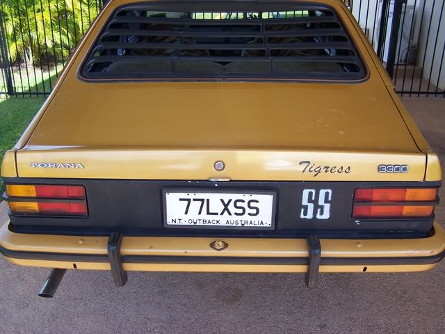

#25 _Brewster_
_Brewster_
Posted 03 July 2007 - 09:11 PM
Here is the rear view of the car, unfortunately, I can't keep those plates when I move interstate at the end of the year. Bugger. I know the Aunger sunshade thingy on the rear windscreen has to go, but boy it keeps the heat out. What does everyone else do? I see the venetian shades that go on the inside for sale on ebay, are they worth getting? Or does everyone else just keep parking in the shade? Fortuantely rare spares has new lenses for that number plate light, and I have two NOS tail lights to go in as well, courtesy of ebay.
