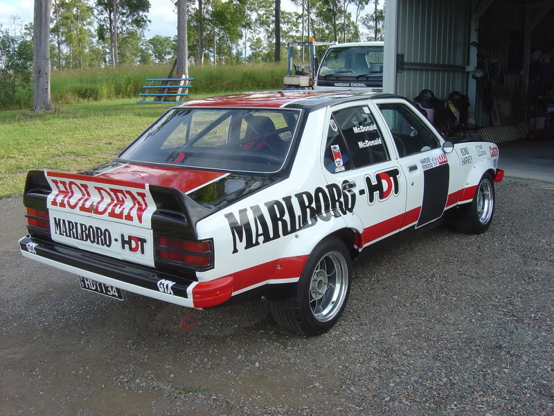

Hi Mum! I am home nice and shiny! Thanks to MRNOS!
Edited by rorym, 02 May 2009 - 03:48 PM.
#132 _Lxrana_
_Lxrana_
Posted 02 May 2009 - 03:48 PM
Looking very nice Rory :clap:

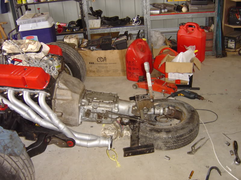

One Renagate sequential shifter fitted...needed some bending of the rods but pretty staright forward...whole unit goes back into the car tomorrow then just need to connect eveything and fire her up.

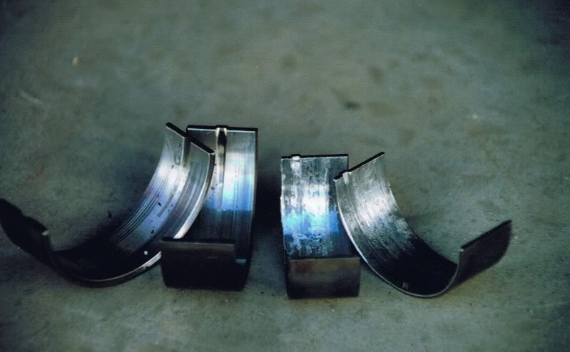

The culprits!

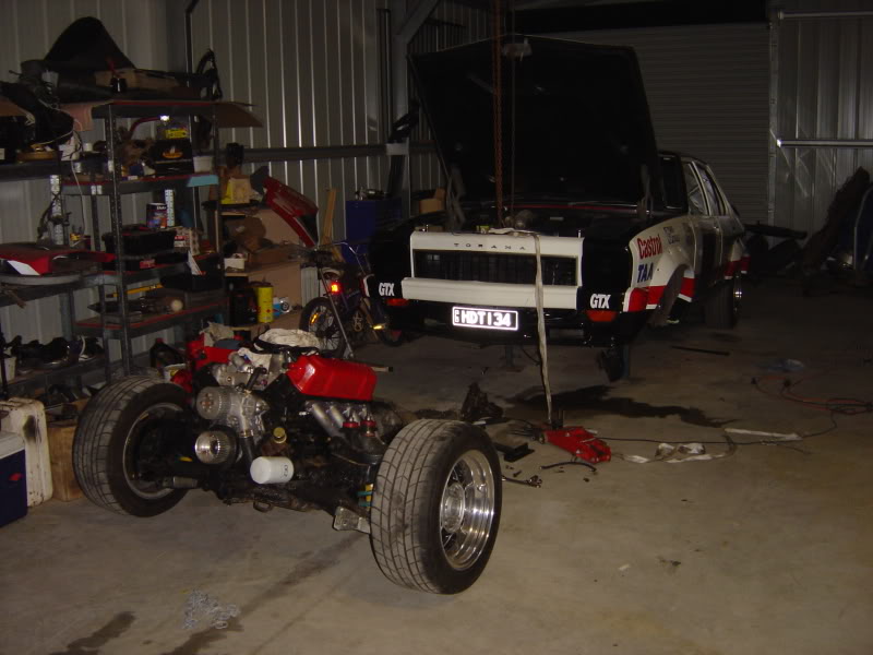

Weird...Lined up the motor and Toploader on the floor...slipped on first time!..and it was in gear!!...Then dropped the body onto the unit..same thing! First time!...something must be going to go wrong!
Just oil, water and a few other bits and shes finished.

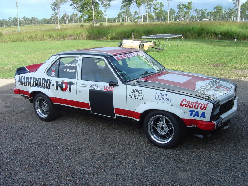

week and a half....waiting on connection from Chris Mills and the mech oil gauge is it...then wheel align check...everything else is spot on...final run around checking the paint so its shiny everywhere..thats it...looks a million dollars at the moment...hope it runs as good as it looks.

Have to ask R, what caused the bearings to scuff up?? lack of oil pressure from oil surge? as I remember you wanting a HE sump as one stage????
Who did you get the extractors from? and how much do$h
#147 _rorym_
Posted 20 May 2009 - 05:06 AM
The engine was clearenced for 25W60 oil..I started running 10W40 without asking then the spin so the combination of the 2 we think. That car runs a HE...The other sump was for No.2
