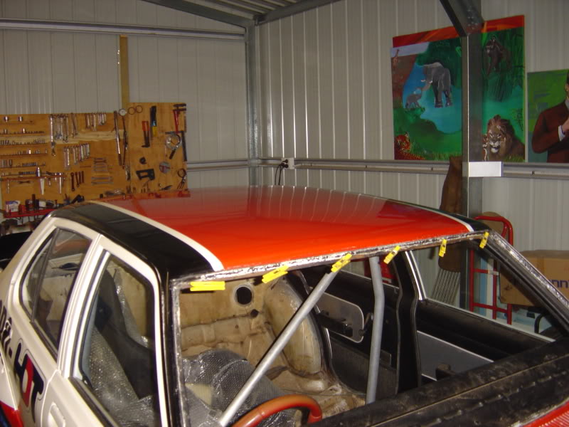

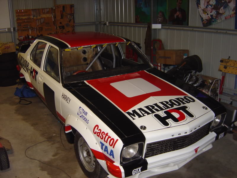

NOS hadnt done the boot lid or roof so rubbed them down and did the cut and buff...Looks a million dollars now, body all finished, fitted the steering column to rack, plus booster and master cylinder.
#166 _rorym_
Posted 20 September 2009 - 05:52 PM
