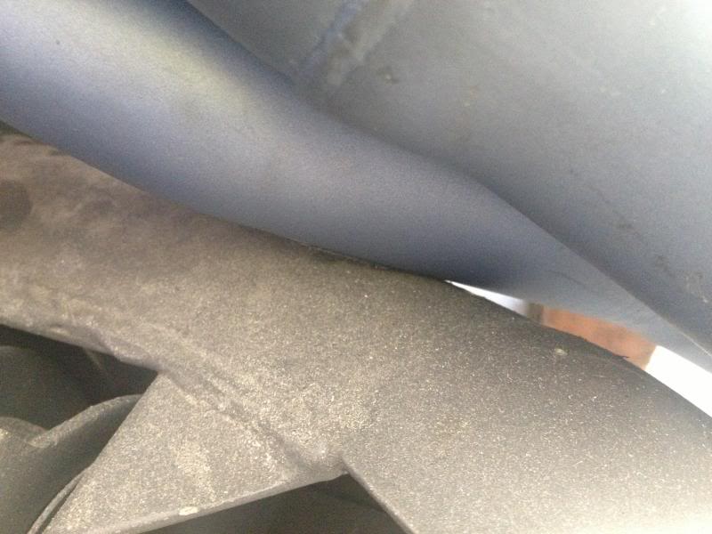

Sat the engine in the K frame earlier in the week and began to bolt the ancillaries on ready for install today.
ended up using bits off the race car to hurry things along.
Clutch and g'box went on well, but i struggled to bolt the pacemakers up. the passenger side just kept fouling the rails. I took a punt on the headers being bent in all their travels and bought a brand new set from Datto friday.
Waste of money that was, no difference at all.
Next failure was the drivers side wouldn't bolt up with the flexi steering coupling. so we tossed that in the corner for a minute. The drivers side sits against the sump too.
Pulled the mounts off, changed them for the Tuff Mounts out of the race car to see if that has any difference.
Nope.
rolled the engine under the car, dropped the shell down over the engine, k frame outriggers bolted straight up, gearbox crossmember fell into place, do you theink the front k frame to body mounts will line up?
Not a chance.
On top of that, the MSD dizzy cap fouls the top drip rail.
thrown it in for the day, bit not happy.

Every body you talk to has trouble with extractors on lh lx torana cant someone make a set that actually wont foul any part of the car
keep at it mark it will come together been there done that still going

Hey mate, no fun at all! The trimming of the drip rail for MSD dizzy's is a common one, but the fitment of your extractors is a real bugger.
What part number are they out of curiosity? A few things with mine.....I'm running VN headed 304/308 to suit HQ Pacemakers because no-one did 1 3/4 primaries for VN heads in Toranas back then.
1 - The guy stipulated I would have to run a double uni to make it work which I did - no dramas on drivers side.
2 - Going back nearly 10 years now the high energy pans were a little different, and I remember quite a few people having drama's with Pacemakers fouling on the larger pan on the drivers side. So I took some measurements and sent them to high energy who made the pan to my specs which worked well. EDIT - From memory I'm sure I've spoken to someone who said the pro-circuit pans high energy were doing no longer fouled pacemakers.....not 100% on that though!!
3 - Finally I discovered I had to trim a piece of my passenger side k frame outrigger which I then fixed by welding in a piece of 3mm angle iron.
Sorry you've bumped into all this at this stage of the build mate, most upsetting!! Although now I think about it, I cut my drip tray after painting the car, and after some touch-up paint you wouldn't pick it.....not that anyone ever looks.
It'll be worth all the effort mate, hang in there!!

Shit I have used all the same parts in the past with none of those problems the only problem I had was the passengers side extractor was to close to the lower firewall and burnt a hole in my carpet .

Old headers are 5500 and the new ones are 5260

I've got the 5260 headers in mine and had to run the double uni joints. The factory rag joint rubbed real bad, but was always going to run double uni's so left the headers untouched,

I ran a torana uni on top and subaru uni on the bottom......I think from a brumby but I cant be 100% sure....

I'm  sure theres plenty of efi headed toranas out there with these extractors on them
Maybe its the mounts
Tuff don't make Torana mounts they just make 1 that they say suits HQ aswell... maybe thats the issue
Can you try some original Torana ones first ?

Did you use non hardening sealer on the front & rear windscreens? You could use a second uni and this will give you some extra room but from the photos I recon it would be tight even going this way. You could muck around for ages trying to get the extractors to fit so if different mounts don't help take pictures & measurements rip them out and sent them to a good exhaust centre and get them modified to suit.
I had two different brands in my hatch and both didn't fit, they hit every bloody part of the car and engine. In the end I sent both back and sent the car to our local exhaust centre and they made me 1 7/8" extractors and duel system all Jet hot coated for $2,500.00 but it was worth every cent in the end not to have any interference issues and when I fitted the power steering twelve months later it cleared by heaps.

Did you check out the Genie version of those pipes
They claim to fit (using Torana mounts) inc power steer... not sure how they would know this though
They run 2.5" collectors and similar price to the Paceys

I well remmeber the pain of fitting extractors in a LX, jigging engine mounts to get extra clearance and even then having to modify the pipes and that was 28 years ago, good on ya Pacemaker still don't fit

I'm already down a second set of pacey's and they are in. no need for further pain at this stage.
