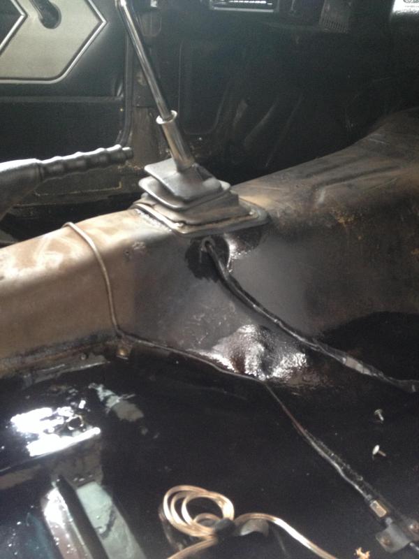

Marty figured out the problem... I switched 1/2 and 3/4 around so 1st is third and 2nd is 4th. Whoops. Makes a lot of sense now.

Just a swap over at the shifter's all that's required. You can see in Jacob's build pic he got them mixed up.

Well I'll have to fix it but I'm used to the reverse pattern now lol. How do I swap then around as the rods won't line up the other way? Do they have to be crossed over one another?

I mixed up the linkages on my LH years ago. Found out on its maiden voyage right after crashing it into a barbed wire fence,
Was not happy!

Shit!! Well at least all I did was fry my clutch a tad. No wonder it didn't spin the wheels when I dropped the clutch the other day.
