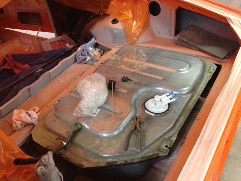

This was haow I was going to set up my boot area.Tank and spare.
Attached File  85 resize.jpg   196.35K   10 downloads
now going to elimimate spare. Tank is to be made to size

Are you still planning to mount the fuel tank in the hatch area?
I think you will find that the for rego the fuel tank has to be sealed from the passenger compartment which means you can not have a fuel tank or any part of the fuel system in the hatch area. I don't think I would want the hatch area filled with a fuel tank in an accident.
You can put a fuel cell in the boot of a sedan if the boot is sealed from the passenger compartment.
Edited by ls2lxhatch, 23 July 2013 - 08:17 PM.
#98 _LS2 Hatch_
Posted 23 July 2013 - 11:07 PM
I was under the impression you can have a fuel tank or cell in the rear as long as its filler is outside the car, and it's vented out side. If the filler is inside it needs a spill tray around the filler with a drip tube to the outside.
This what I understood from talking to the engineer. I have confirmed most of my ideas with him prior to starting on an area.
Now you have me thinking though, in the event of an accident a bomb behind my seat is not a great idea. May put some more thought to it in the future. For now it will stay as the fuel lines are complete along with the exhaust
Annoy ideas on wheels? Remembering it now has been set up for commodore stud pattern and offset.

I know a guy that has a fuel cell with the filler inside using a spill ring, told me to make mine fill from the outside. reckons it stinks the whole car out and the smell doesn't go away.

Mine is now set up with the filler neck outside the car in the original position. Hopefully that will keep the smell out. In an accident does concern me now though.
