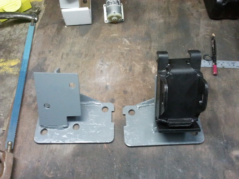

Posted 29 August 2011 - 10:14 PM

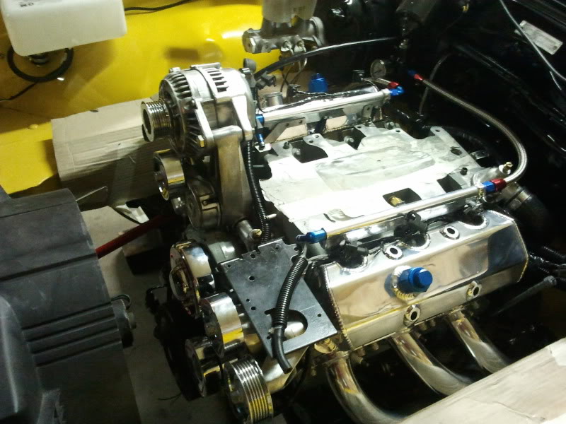

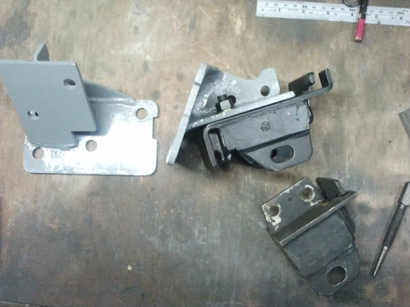

I have had a win over the weekend. I modified the engine plates to accept standard Torana 308 engine mounts so I don't have to run the pissy 6cyl (202) engine mounts. Not bad for a sparky and second time I have picked up a stick welder lol.
I moved the engine as low as I can to give me some bonnet clearance hopefully haha

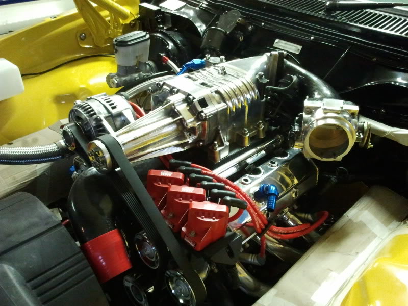

Posted 31 August 2011 - 11:05 PM

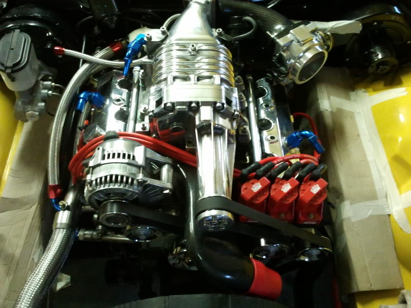

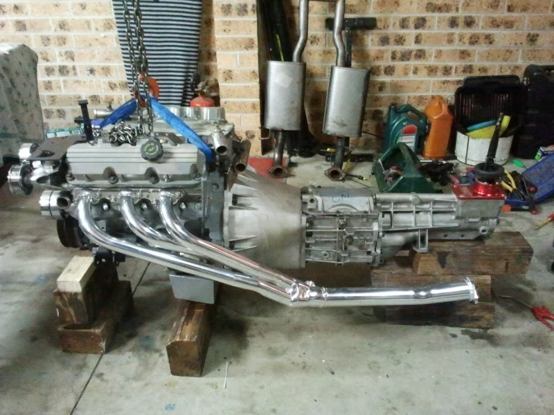

Ready to go in after 6 month build up :)
#354 _V6 UC_
_V6 UC_
Posted 31 August 2011 - 11:15 PM
Bout bloody time :P did u get your pulleys hpc coated or buy them from somewhere? Look good, I want to do something with mine, they just black n look shitty
#355 _youngy_11_
_youngy_11_
Posted 01 September 2011 - 08:08 AM
Pulleys are from killkenny castings. Some a slightly different size but should work out ok.
Im going to have all chrome pulleys. I got the water pump and alternator pulleys chromed.
Youngy

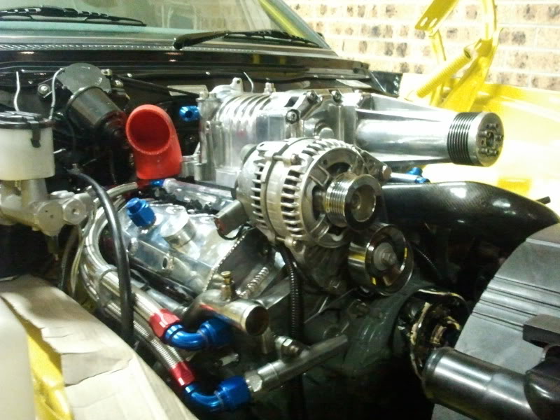

Posted 22 September 2011 - 09:46 PM
So motors in.
I have finished the engine wiring following some motivation from Toranafest :).
Have fitted the -6 fittings onto the braided fuel lines and hooked it all up.
Today I ran the -12 braided heater hose.
Waiting on some -7 hose too join the fuel rails then the intercooler plate and blower can be properly mounted.
Heaps happy with the outcome so far.

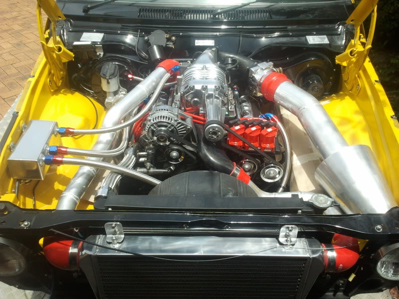

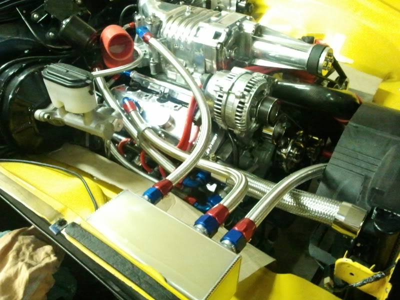

Posted 31 October 2011 - 08:50 PM
Have been a bit slack over the past month as the fab shop has been flat out and I have lost a little motivation, plus a couple of big weekends including Bathurst. lol
Good news the inter-cooler pipework will be done this week.
Since last update:
Interior finished including boost gauge, shift light and some other wiring changes have been done.
Blower, throttle body etc is all mounted up.
Throttle cable has been shortened to suit custom bracket. Working well.
Engine is full of fluids and is turning fine off the starter :)

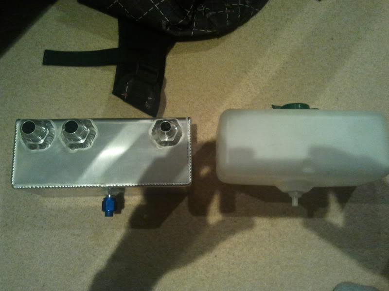

Have had a custom Oil catch can made and drop tank is being modded so that pump is located in the middle/rear of the tank with baffled section around it to stop surge issue.
Should be running this time next week finally!!
Enjoy:)
Oil catch can to replace original washer fluid bottle. -12's to rocker covers, -10 to vacuum to make it legal.
Catch can installed

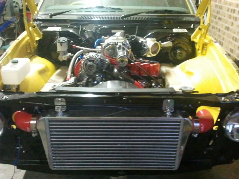

Inter-cooler pipe work is done,
Fit drop tank tomorrow then fire up!!

#372 orangeLJ
Posted 03 November 2011 - 07:46 AM
missing some hoseclamps! haha.
front pipework is great (short run) but that long run on the inlet side of the cooler is loooooong (but necessary)
will be good to see what it pulls on the dyno :)
#373 _youngy_11_
_youngy_11_
Posted 03 November 2011 - 09:44 AM
Yeah not much that could be done. Its a good 3-4 ft shorter all round than commodore installations as the pipe work has to go down to the inter-cooler inlets at the bottom.
