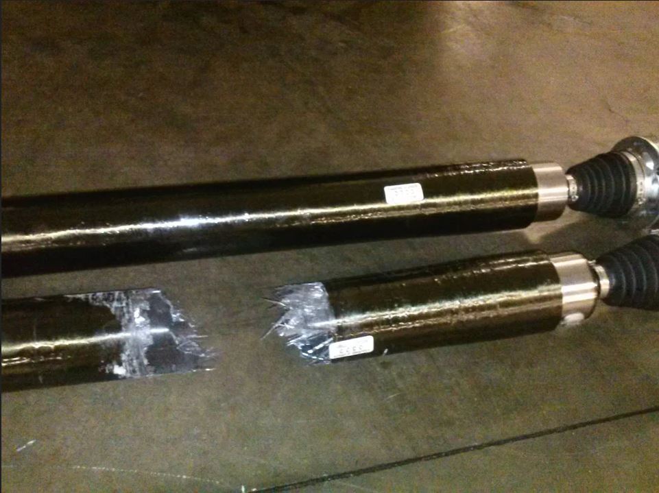

  • 9,785 posts
Posted 01 August 2020 - 12:16 PM
Well, if you win lotto...................................
Attached File  Carbon.PNG   1008.43K   16 downloads
#420 Bigfella237
Posted 01 August 2020 - 12:30 PM
Carbon Fibre is good because it's strong and more importantly light weight, but I've read they don't suffer much abuse by way of stonechips or a light impact...
