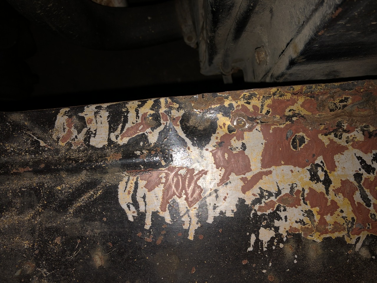

Wire wheeled the rest of the area on mine back to the metal at the weekend.
Definitely no sign that there has ever been numbers stamped. So I guess that stands to reason then.
Also wire wheeled over the welds. Definitely same paint and primer as the rest of the car as I peeled through the layers.

Got a better pic of those welds there?

Hi the only way to tell if the skirt panel has been removed is to clean the spot welds attached to radiator support, easy to identify spot welds,  the welds on the skirt dont look right,    Hanra has put up a clear photo of the 3 short welds, on how they should look

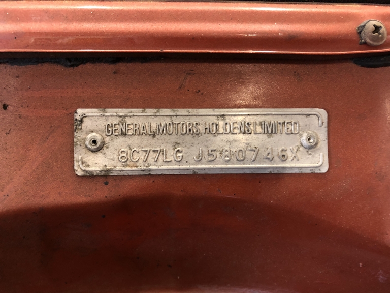

So I wonder with that 2.7 limit whether that means ALL SL/R's were build in OZ? And they just never added an ADR plate, because us Kiwi's don't need to comply to any aussie rules!....LOL
#49 S pack
  • 15,752 posts
Posted 15 February 2022 - 07:08 AM
The letter prefixing the PSN tells you where the car was built. The tag below says J580746X, the J stands for the GMH Dandenong VAP in Melbourne, Australia.
Any Holden or Torana assembled in the Trentham VAP in New Zealand will have a Z before the PSN instead of a J.
If this Torana had been built at the Elizabeth VAP in South Australia the prefix would be an L.
So if the Torana in the pic had been assembled in New Zealand the VIN number would read 8C77LG Z (followed by the 6 digit Trentham PSN) X.

Posted 20 February 2022 - 08:59 AM
Hi Guys
Here are a couple more photos of the welds that you were after.
Still looks original to my eye. Mainly because all the paint layers match the rest of the car. I guess someone could have used exactly the same paint layers ( including the red oxide primer) when repairing, but what are the chances.
