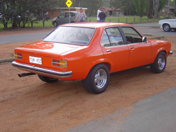

Painted BMXer's car with 2.5 HP compressor, and a spray gun recommended at the auto paint shop. Works OK. I paint with about 40psi of pressure which works for me, more paint on the car than in the air. Also, don't forget to buy a decent water trap.
For what it's worth, I also found painting a whole car to be much better for improving your technique rather than just parts. Heaps more time/area to perfect your technique.

Thanks guys for the advice. Yella looks like you did a great job on the BMXer's car! Is that acrlyic paint?

Yup, acrylic. I love my acrylic, it is so forgiving. You have to be a bit more precise with 2-pack. BMXer paid a guy to buff it. After my recent attempts at buffing, was prolly a good thing, but I'm getting there, just more practice. For those that haven't attempted buffing with lambswool, they are right about always keeping the buffer flat, i.e. don't dig the edges in!
