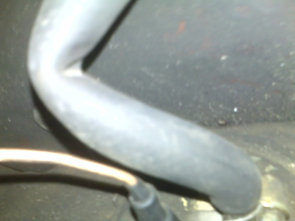

Thanks heaps for the hints and suggestions. I may be a bit slow to try them all out as I have other priorities and not much time these days but I did get an hour or two of Torrie time this arvo so I crawled under the car for a look see.

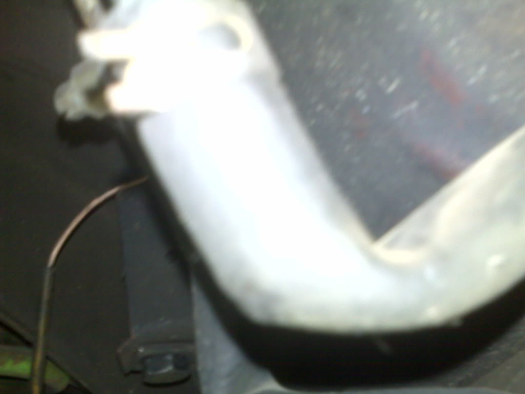

Fuel or ignition? Might be one or the other or a combination of both. Anyway, here is what I found.
Traced the fuel line back from the fuel pump to the tank. When I got to the tank I found a decent sort of kink in the rubber hose that connects the metal fuel lines to the tank.
There are two lines and both are kinked
Might not the be root cause but definitely something that requires fixing. Any wonder the dyno dude said I had a drop in fuel pressure and recommended an electric pump or bigger mechanical pump.

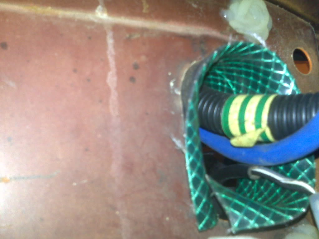

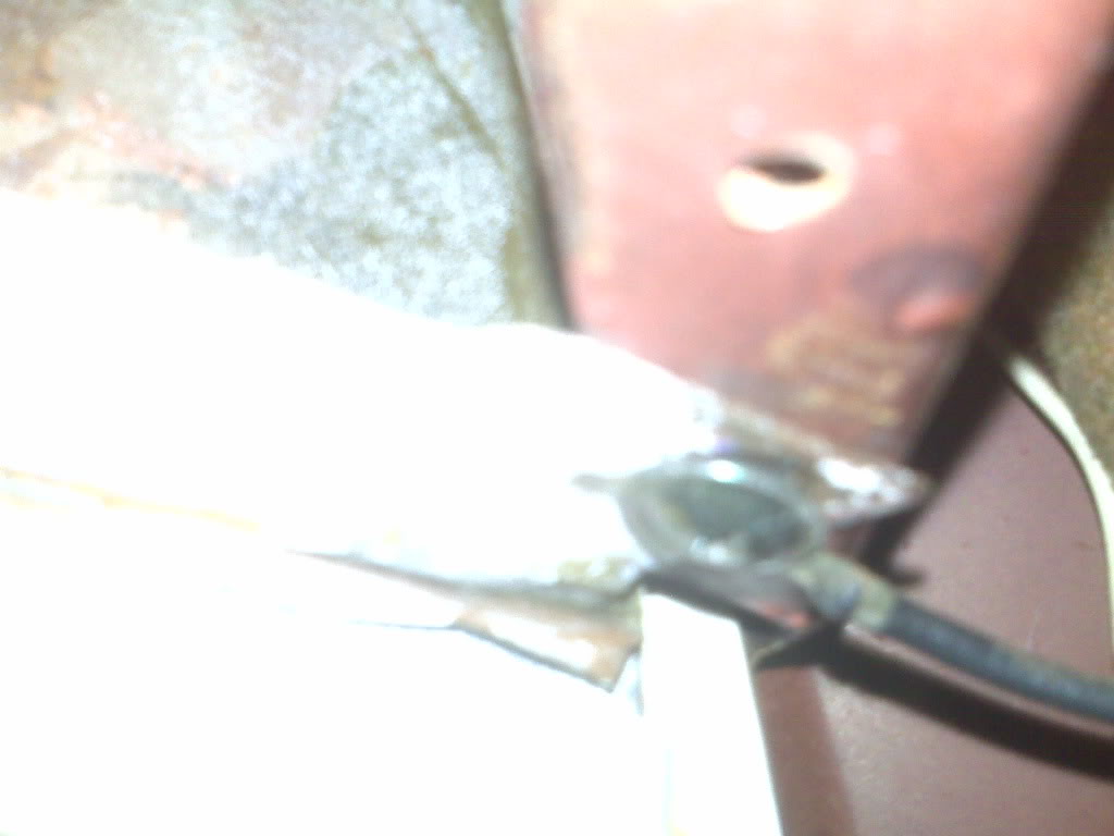

Not sure if the following is relevant. The coil and crane unit are mounted to the inside of the firewall (in the cabin). Therefore the coil lead and the wiring from the dissy have to pass through the firewall. The two wires although insulated are touching. Like I said, Im not sure if this is relevant.
I checked for loose connections and took note of where the earth for the crane unit is located. The wire is screwed in tight but maybe the earth isnt in the best place. See below.

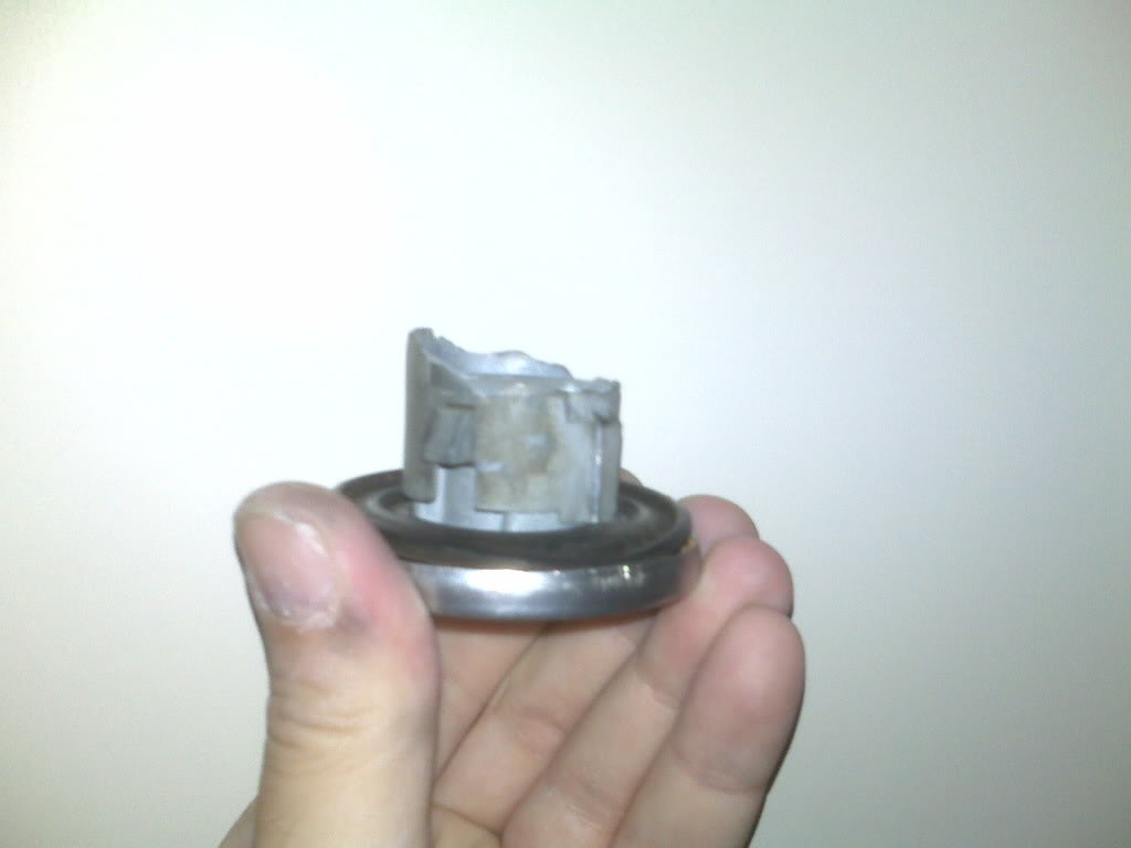

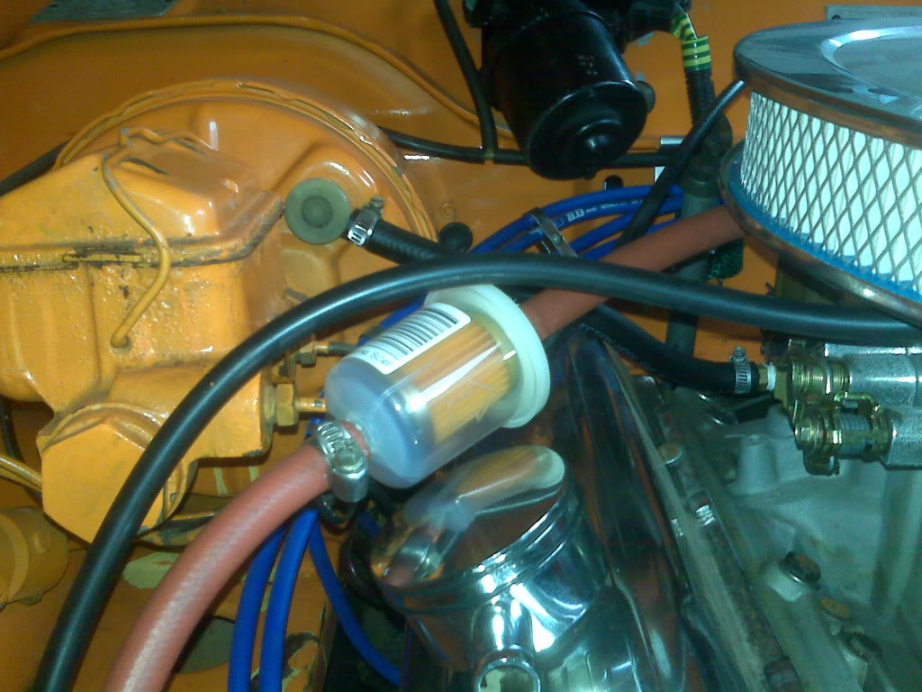

I also took a few photos of the location of the fuel filter. The broken fuel cap and the car that doesnt give me any grief :D
Next time I have the time I will start the car, wait for it to die and check for spark. I will have to zip tie a lead close to block to do this so I can test it myself. That will be next weekends effort.

The leads touching will be fine, the condute is on one of them for that exact reason.
I like the "only $1500". You would want to make sure it would fix the problem, you'd be pi$$ed otherwise.
Those lines arn't good either. If they are the problem or not, they'll need replacing.
The filter shouldn't be a problem, might just heat the fuel a bit where it is but nothing to worry about.
The earth is a bit hard to see but shouldn't be a problem if it's tight.
The cap is just.... weird.
