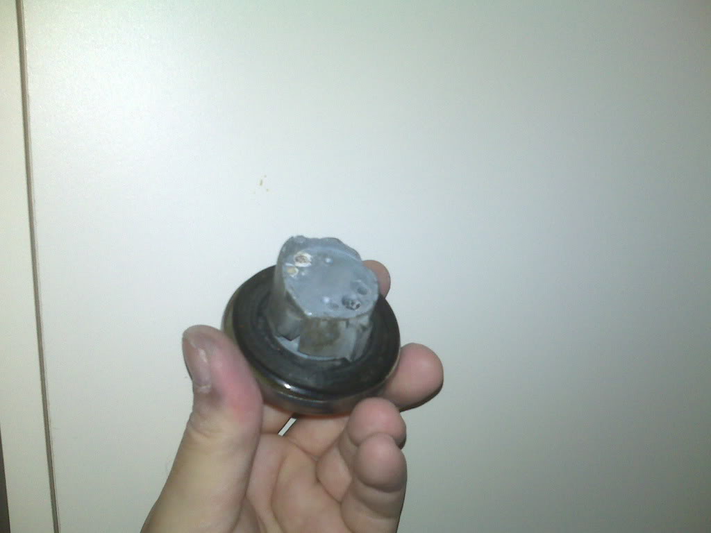

I took the fuel cap to see if it was a vacuum issue and I noticed this.
Not sure if the rest of the fuel cap is in the tank or not. I cant recall it breaking at any time and I wouldnt have thought the fuel fumes would weaken the metal to such an extent.
#50 MRLXSS
  • 12,415 posts
Posted 31 March 2009 - 12:07 PM
Have you got a fuel filter on it? Check and change that... replace with a clear bulb one if you do, so you can see if any gunk gets caught in it.
