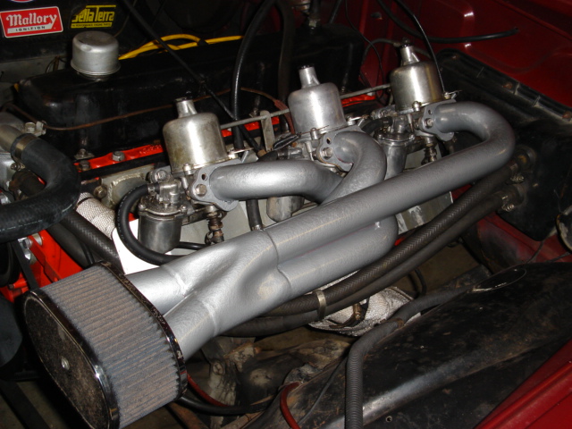

#241 Dave6179
Dave6179
  • 577 posts
  • Name:David
  • Location:NZ
  • Car:HJ, VN, VX SS
  • Joined: 23-August 12
Posted 30 August 2014 - 10:25 AM
I had 17.5 as well with 6 inch ram tubes. No difference felt going up from 3" tubes. Now I have a 29" extractor style inlet, from the carbs, with a Weber filter next to the battery, and the difference was surprising. Far better than ram tubes or the airbox I used to have on it. Initially I made it for a totally different look and when I tested it before finishing I felt a lot more pull from quite low down right through to around 5000. The 3.55 diff feels too low, but the soon to be installed BW will get 3.45 gears so should be better again.
http://oldholden.com/node/107461
Page 2, from post 42 - http://www.gmh-toran...u-set-up/page-2

#243 N/A-PWR
  • 9,642 posts
Posted 30 August 2014 - 09:24 PM
Dave,
Your Extractor inlet Ram Tubes are amazing:-
http://www.gmh-toran...e-2#entry722566
thank's for posting,
and I gave you a Like Button for this.
