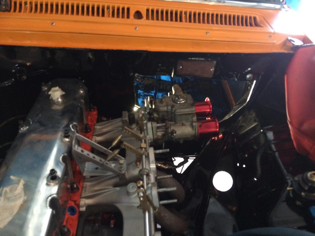

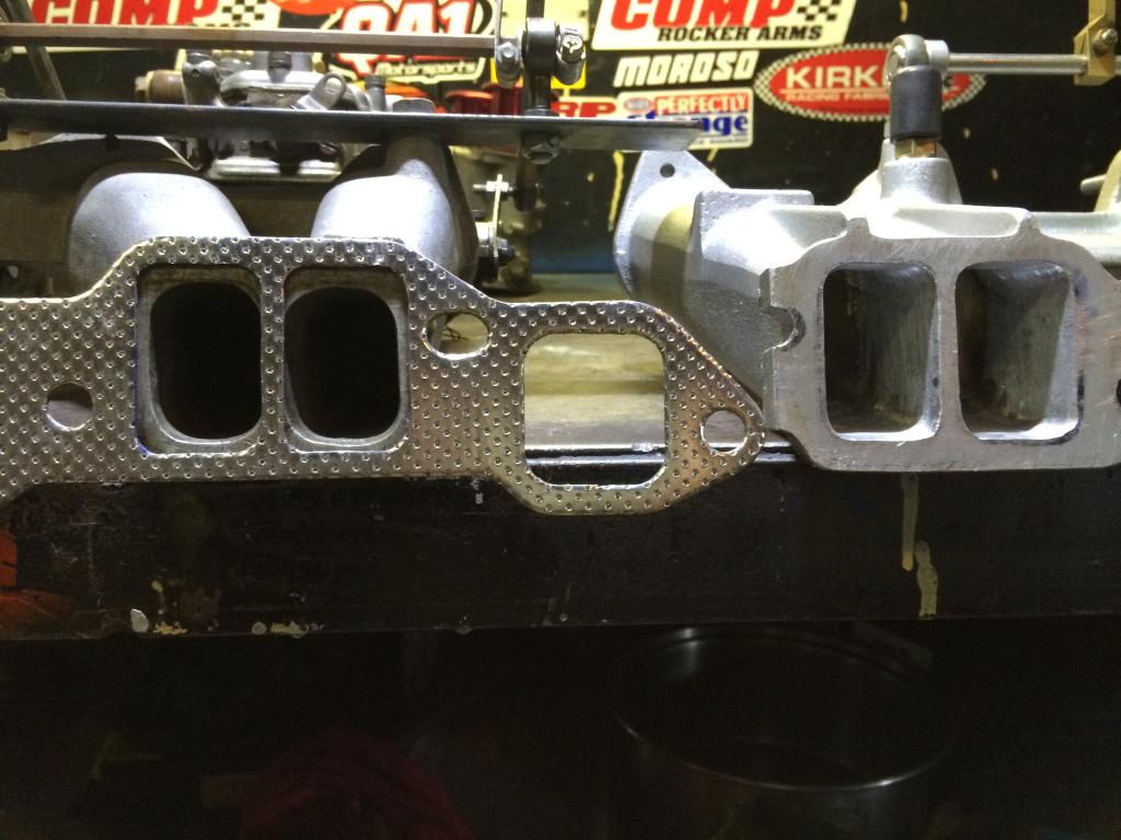

Posted 09 June 2014 - 02:00 PM
Alright this has got me f%*$ed, it will miss/stutter even free revving.
I've swap Ignition box, coil, distributor, cap and lead's with known working ones and its still the same.
i would think it would still free rev, even if it was too rich.
Anyway's, the before and after manifolds.
1/2 sq in difference in csa in each port
and then out came a chunk of the firewall, the old manifold is a kicked warneford meant to fit an EH.
I'm happy with the engine, not a trace of reversion in the intake.
Ive bought some 135 main jets and 210 air correctors to try on the dyno, but i've tinkered with 2 other 12 port engines that had weber's with 40mm chokes and they were both fine with 155 mains and 185 air corrector's so I can't see why this is so different??

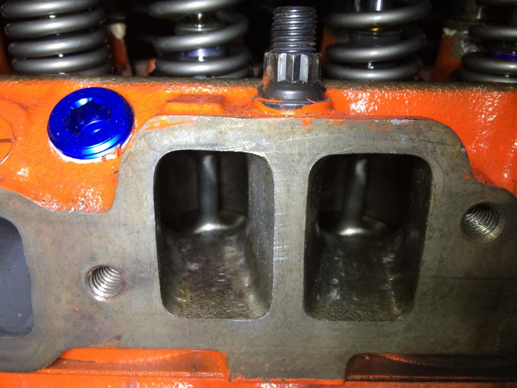

Swapped the plugs as well....
RIP....
Pulled the intake off this morning to swap it with the bigger one, it's developed a hole in no6 intake port, it wasn't there a week ago.
Looks like we're back to square one.

I just hit the head with the die grinder, looks like a casting flaw.
It's .040-.050 thick around the hole!!!!!
Thanks Ned, unsure what direction I'm going in now though.
