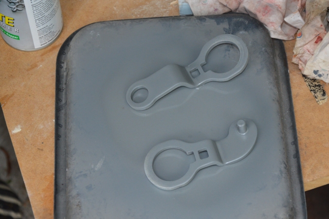

anyways dad bought me some paint which was just the same stuff i used before.....which seemed to work so yea.
So i sanded back these terrible things to clean them up a bit.
And realised once again i suck ass with paint and i put to much on and it has run lines down it sooooooooooooooooooooooooooooo ill have to do that again. (i saw everyone else hang there bits for painting so i thought i would try that too)

#578 _Quagmire_
_Quagmire_
Posted 01 November 2013 - 01:32 PM
many light coats hamo...

#580 madtoranajzedded
madtoranajzedded
    Sir ask alot
  • 2,893 posts
  • Name:Maz
  • Location:Southern Tasmania
  • Car:72 LJ SL SEDAN.
  • Joined: 30-September 13
Posted 01 November 2013 - 02:24 PM
dont worry too much if it looks terrible when u put paint on ,give it time to settle and you will be surprised,if ya got cardboard box
hang it in that, away from the dust for a couple of days

Belt driven, make sure it will run on whatever power points you have (10/15amp) and check the fittings make sure they are nice and not cheaply alloy stuff
#582 _judgelj_
_judgelj_
Posted 01 November 2013 - 05:27 PM
Make sure if they are hanging you don't go too heavy as gravity will create runs. Apart from that you would be surprised the finish you can get. I hit a fuel pump cap with aerosol and it came up like 2k glass. Nowhere near as tough just goes to show how smooth and clean the surface has to be
