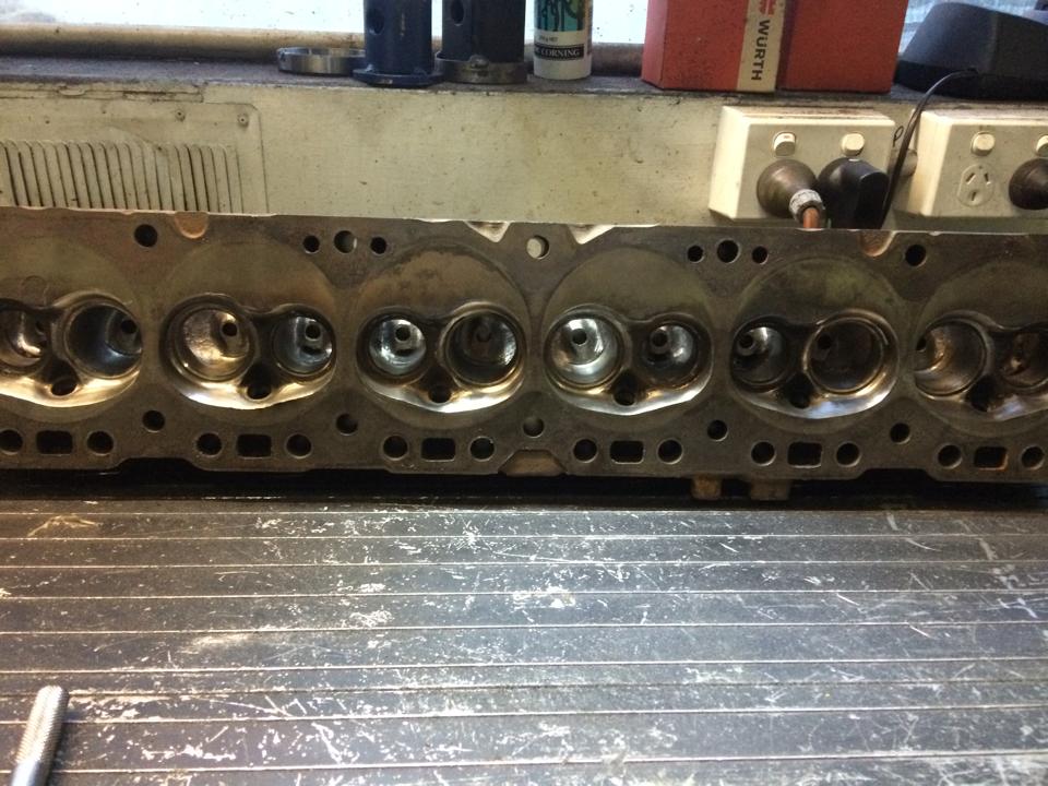

Posted 06 June 2014 - 07:10 PM
So bit of a wordy wordy update, again.
Kev sent me this pick this arv, my new head is progressing.
He says he's done on the grinder, just needs some work with the flapper then off to the machine shop and the flow bench.
So as i said, my new head is progressing.
After a bit of discussion we made a few decisions.
I degreed the cam i have properly a little while back, and have been sitting on the exact figures for a while, but they seemed very lazy to me. Lots of seat to seat duration for the .050" duration and not a lot of lift, really.
What i came up with was 310 degrees seat to seat, 259 @ .050", and .365" lift at the lobe.
So realistically a very lazy profile in anyones terms.
So it has been decided this car will be getting a new cam while were going. On the plus side, will have a lot less seat to seat duration, so be a lot more streetable, and on the plus side will have even more .050" duration, which is always good, and on the plus side will have more lift, which wont hurt.
So in short more streetable cam with more area under the curve = more go fast and easyer to live with.
Looking at comp grind 6333 for the intake, exhaust is undecided at this point, will wait to see what the port flows on the bench and get Kevs recommendation.
While we were throwing money around, I decided to look on the precision website again, as i was never happy with how my old slugs were machined, and discovered they now stock flat tops with a 1.658" compression height, so the same as the old ACL race series slugs which my block is machined for.
PReviously they only had 1.68" comp height pistons, which would have put new pistons to far out of my block, but now that these are on the market, it looks like i'll get some flat tops as well.
Sadly there only available with the thick 5/64" rings, but im betting a 1/64" difference in the rings wont be as much as an extra point and a bit compression, and way better squish pattern.
Not sure if anyones tried the thick ringed pistons at higher RPM yet, so i suppose once i get this thing together we will see how 5/64" rings like 7500 or so rpm haha.
#269 N/A-PWR
  • 9,639 posts
Posted 06 June 2014 - 07:44 PM
Great write up there DJ,
Just to say that the standard 202 rings that I have revved to 7500 rpm, gear after gear every day Hyundai, do well,
 so in saying that, thinner rings will bed in more ( better Compression ), and wear out the bore quicker ( the motor will need a rebuild by then anyway )
- all that was a thought about physics.
