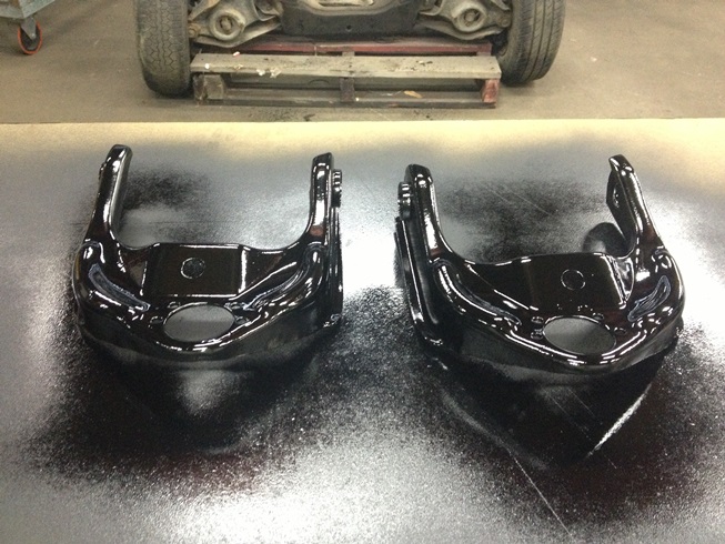

#138 eyepeeler
eyepeeler
  • 1,959 posts
  • Joined: 16-August 08
Posted 15 May 2013 - 10:14 PM
Got around to painting one side of the sub frame and control arms etc. Turned out ok I think.
Attached File  Sub Frame Paint 01.JPG   125.38K   8 downloads
Attached File  Sub Frame Paint 02.JPG   123.79K   7 downloads
Attached File  Sub Frame Paint 03.JPG   144.74K   10 downloads
Turn them over and paint the other side next...
#139 A9X
A9X
    A fortunate run
  • 5,024 posts
  • Name:Welby
Posted 15 May 2013 - 10:43 PM
whats the other one on the floor?
Edited by A9X, 15 May 2013 - 10:44 PM.
#140 eyepeeler
eyepeeler
  • 1,959 posts
Posted 15 May 2013 - 10:56 PM
Hey Welby, its the original one that was in the car when I bought it. The one I painted today came from forum member outer control. It came from a UC as you have probably figured out.
