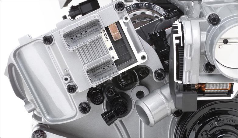

From what i've read / from what it says, its a 32-bit Bosch Motronic ME9 ECU and is supposed to be one of the most powerful and sophisticated ECU's currently available for automotive use. Its micro-hybrid design embeds all the necessary electronic circuitry on a four-layer �sandwich� substrate that reduces the size of the unit and makes it stronger, allowing the ECU to be engine-mounted.
The ECU can withstand mounting temperatures of 110 degrees centigrade and vibration up to 30g. Engine mounting frees space in the under-bonnet area and eliminates attachment problems at the assembly plant.
So how do you piggy back that little bastard?
