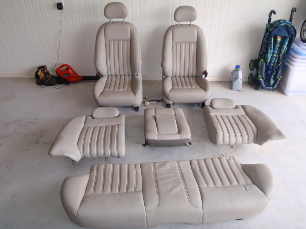

I got the interior for the old girl, although I don't know how well its going to go. All Leather VZ Calasis with electric bucket seats! YEAH BABY! But they'll be retrimmed to suit.
I like the look of the rear seat backs and am hoping it won't be too much of a mission to try and graft them in.
