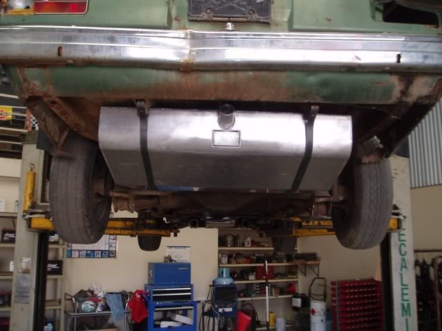

Posted 08 February 2008 - 10:22 PM

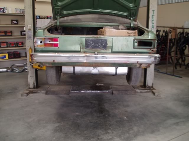

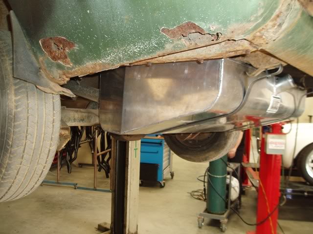

Here are some pics of the tank fitted to the donor car, note, my new tank straps to suit..
The plan here is to paint the tank black, and have those straps chromed.

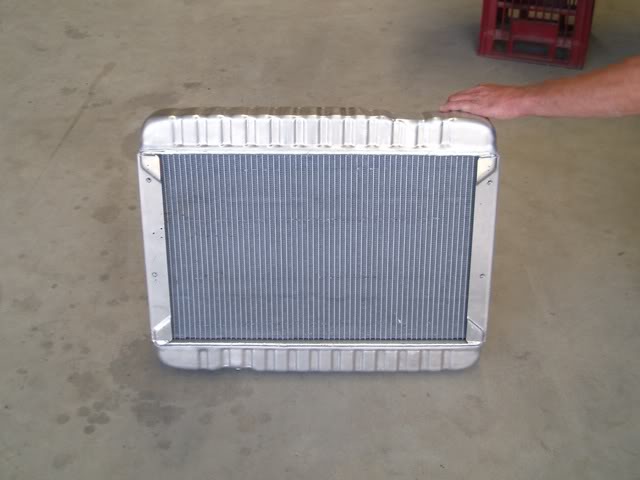

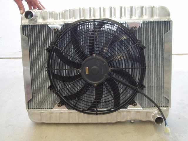

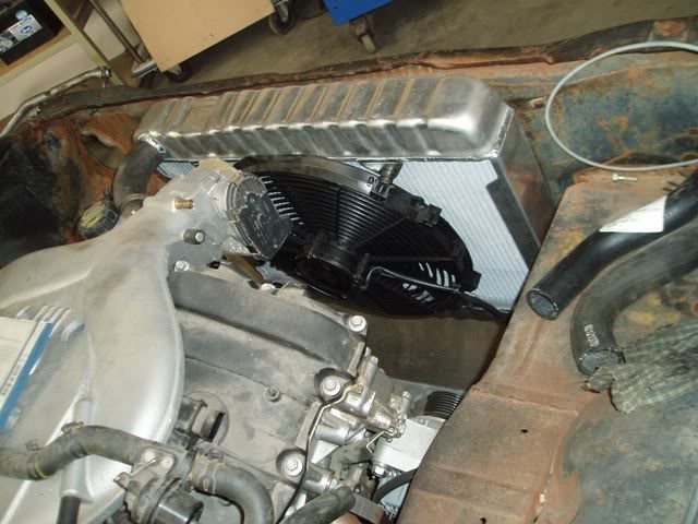

Here are some pics of the PWR radiator,
And with Thermo Fan,

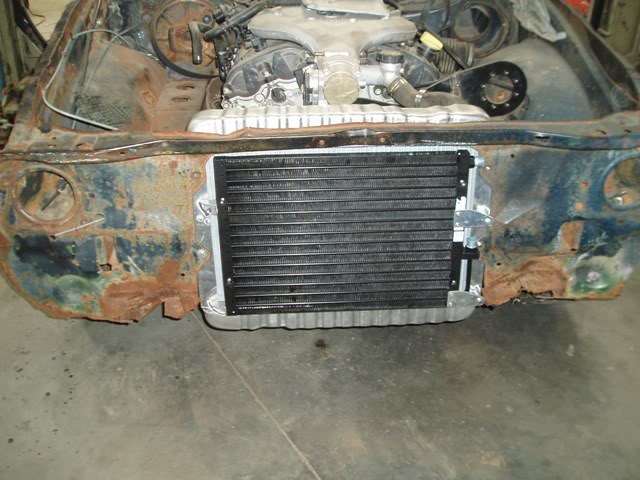

Here are some pics of the Radiator fitted,
You can just see the new headers in this one

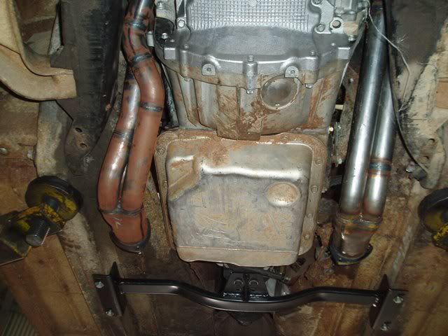

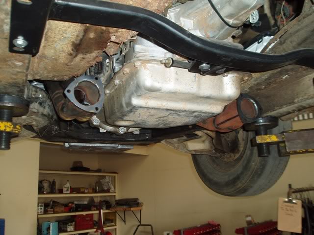

#104 _Brewster_
_Brewster_
Posted 08 February 2008 - 10:35 PM

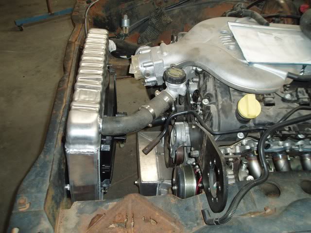

And last but not least, pics of the new headers,
You can see the new Transmission mount, looks good I think.
