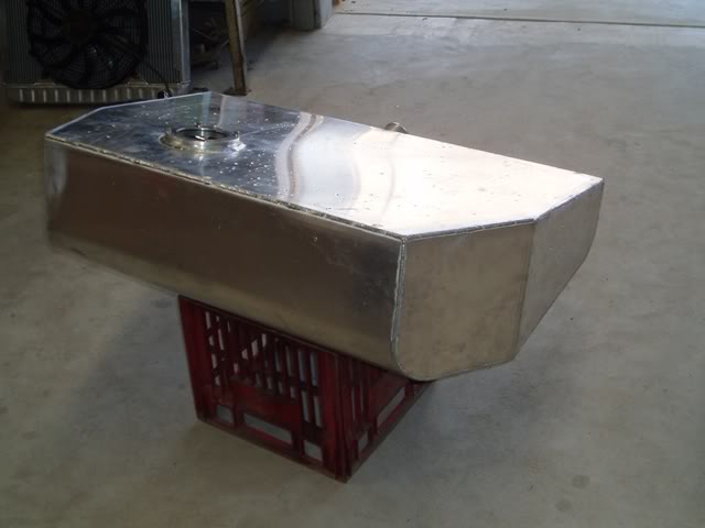

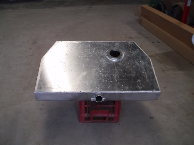

#100 _Brewster_
_Brewster_
Posted 08 February 2008 - 10:18 PM
Ok, here's an update, got some more pics off CAE today, and work is once again progressing really well, thanks to some awesome work fromt the guys.
Here are some pics of the fuel tank, approx 70 litres..
