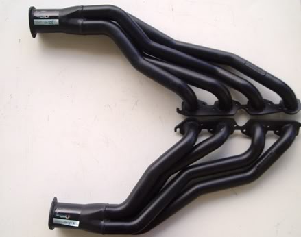

Here are some good tri y pipes..if you can copy this,if not i would try just the 3" straight collector..but i believe the merge collector to be of benefit for your application

Those pipes if your wondering what they are off are from a sb2 headed chevy nextel nascar..but many circuit/trans am/etc use tri y's like these.
Ezy,
....They were 4 into 1s when I went to school..??
We are doing the collector pretty much as your pic shows...

The first pic that ezy 09's posted definatly looks like try Y to me.
#91 ls2lxhatch
  • 5,335 posts
Posted 16 January 2008 - 01:42 PM
If you look closely you will see that the extractors are tri y. The collectors are 4 into 1.

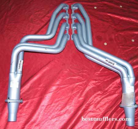

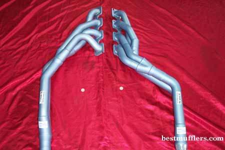

Now I might be getting old but years ago..these were Tri - ys...
and these were 4 into 1s....I see that Ezys collector breaks into 2 but they are 4 into 1s to me. The 4 pipes look the same length into a 4 unit collector.I cant see where his has 2 pipes joining into 1 b4 they get to the collector...which...I am told by exhaust experts..is the principle of Tri Y...or we are all mislead...? Maybe some people call them different things..??
Theseare Pacemakers off the Best Mufflers website. website
Tri-Ys
Tuned 4 into 1
Edited by rorym, 16 January 2008 - 04:39 PM.

They look like tri-y to me, just longer primaries and shorter secondaries than you typically see. What is confusing the issue is the picture of the 4-1 collectors posted below the picture of the extractors which makes it look like one picture.

:rolleyes: Yes thats right ls2lxhatch,they are tri y pipes in the first picture..just making the comparison between an off the shelf tri y pipe & a good set of custom pipes which are made to be the best possible for the engine..not just made to fit whatever or to be cheap.
And the other picture shows a pair of 4 into 1 collectors( one a merged collector the other straight)
And yes the primary pipes are longer for a reason..i guess they do look like 4 into 1's when you dont look at them properly.
But these are proper tri y pipes..some pro stock racers have even gone back to using a tri y...now why would nascar/circuit/trans am or pro stock go back to using an optimum designed set of tri y's...Mmm :rolleyes:
Cause a properly designed set are better.
