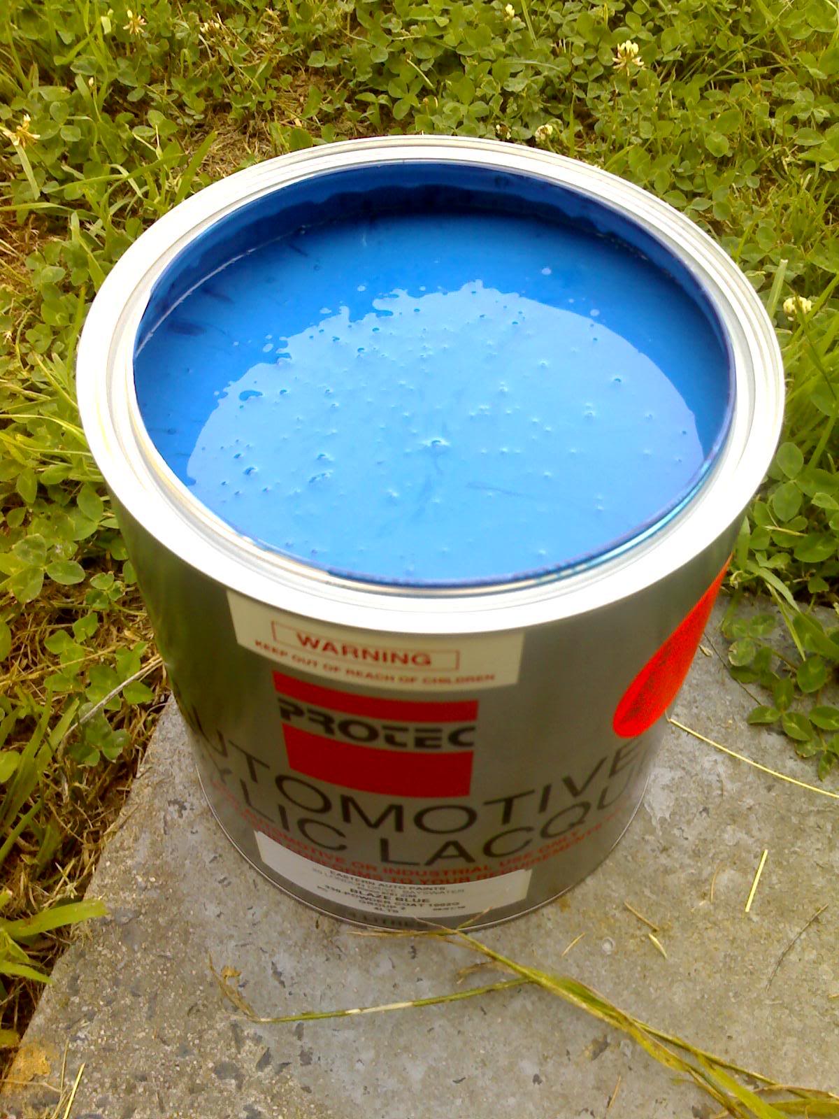

#100 Heath
Posted 07 January 2010 - 05:36 PM
Mmmmm delicious
