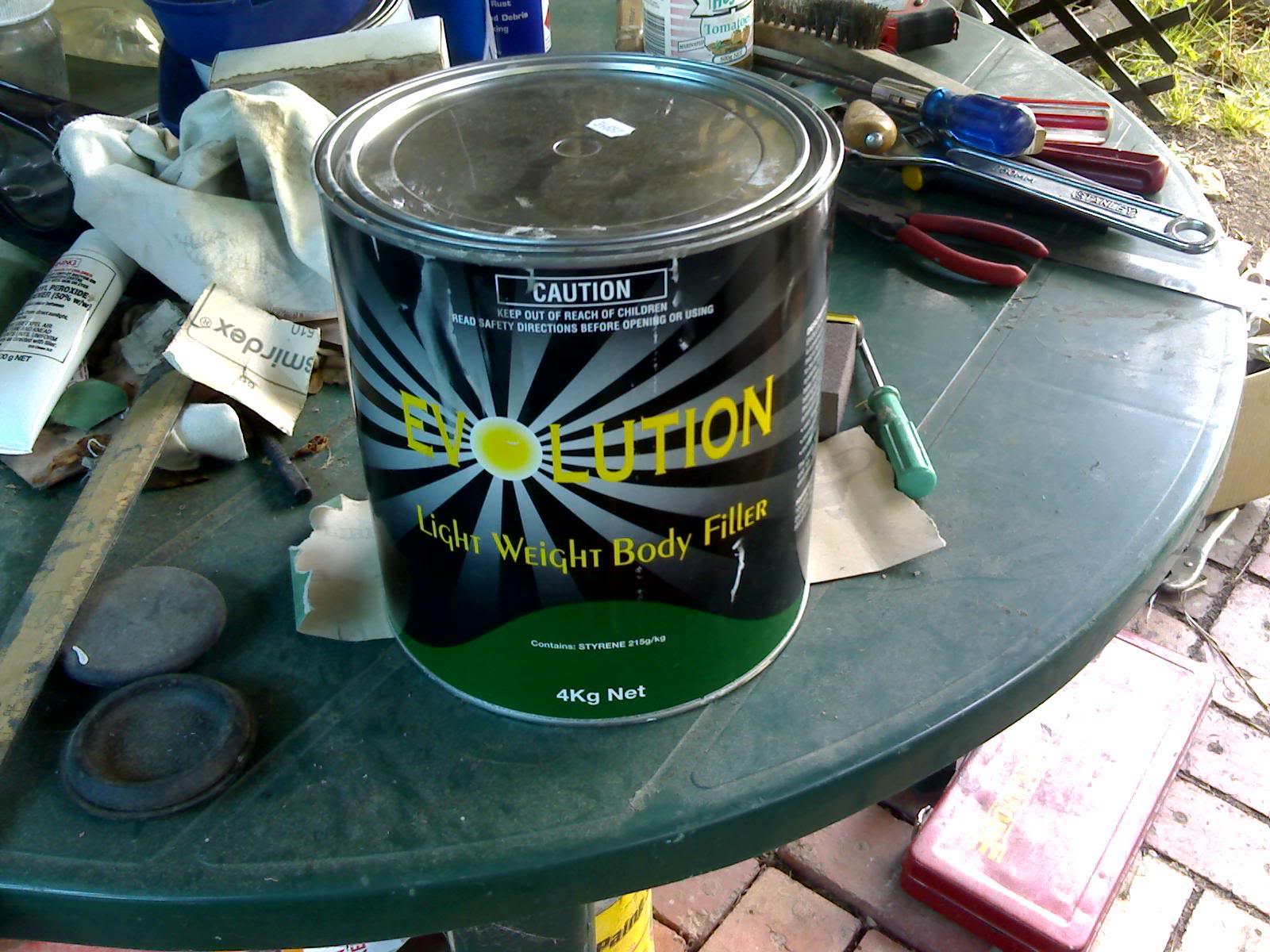

For Matt, and anyone else wondering, this is the (massive) tin of 'PROTEC' bog I'm talking about

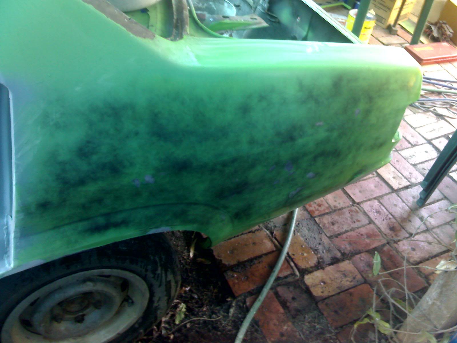

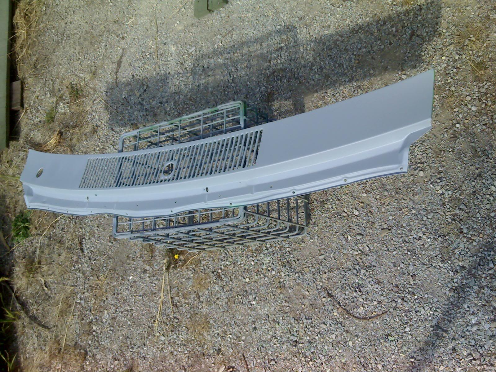

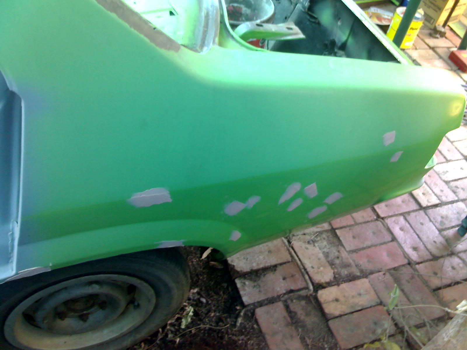

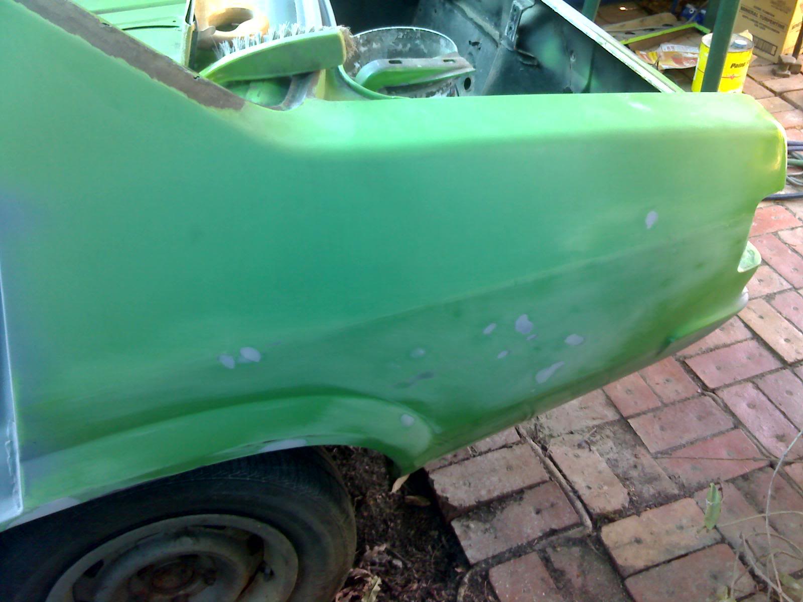

I haven't done a whole lot that looks impressive in photos, but the roof now has chicken pox and I've almost got both rear quarters in primer, minus the welded rust repair I need to do in the bottom of one. Beaver panel is done too. Prepping the cowl is always a bit of a bastard on a car that has been resprayed, because the person before you will have never prepped it properly before they painted it :P Anyway spent a while just scratching the crap off in the vents, cut it back best i could and gave it a squirt.
For anyone interested who hasn't done a lot of bodywork before, this is how I am doing this car, I didn't use this particular method on my last Torana. With the panels on this car, because the paint is generally acceptable, I have no reason to go back to bare metal, but it does have a lot of little 'chips' that have rusted, and they have to be dealt with properly, so the process I am using is: Cleaning the panels decently, bare metalling around any chipped paint and rust converting them, roughening those spots up and filling them with body filler, then shaping the filler roughly with a speed file, and guide coating the whole panel in Aussie Export black and wetsanding the whole lot with 320, finding any lows or highs. If the car was perfectly straight, that would be all the work I would have to do before priming the panels

What do you think of the bog Heath?
When Mike and I were using some on my rear 1/4 I was quite happy with the way it behaved, it does not seem to
clog the paper anywhere near as fast as other types I have used.

Yeah the bog is pretty much better in every way haha

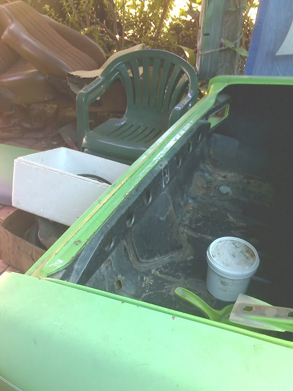

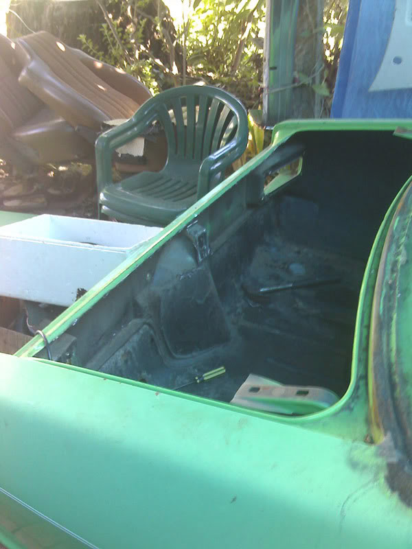

Here's a photo I took a few days ago:
I reckon it's looking pretty good, got a lot more confidence the second time around

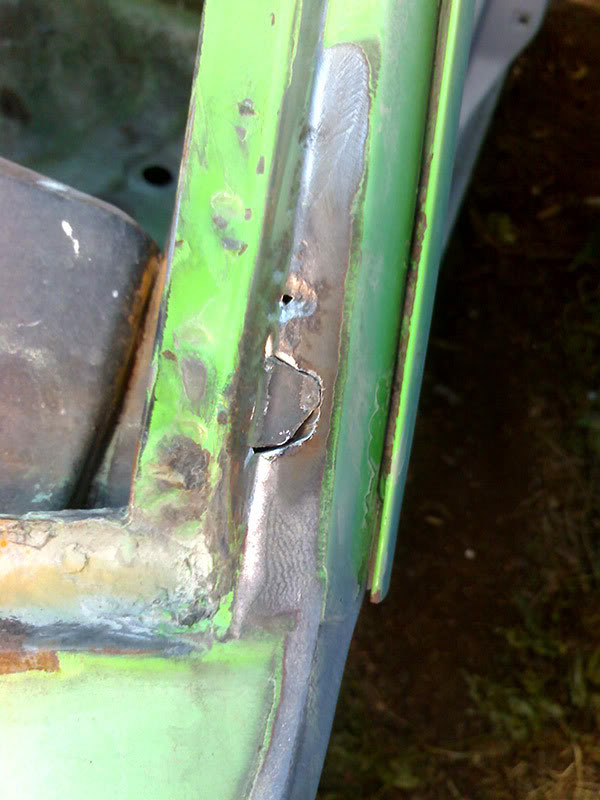

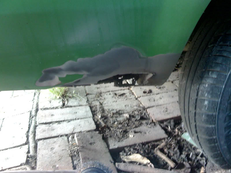

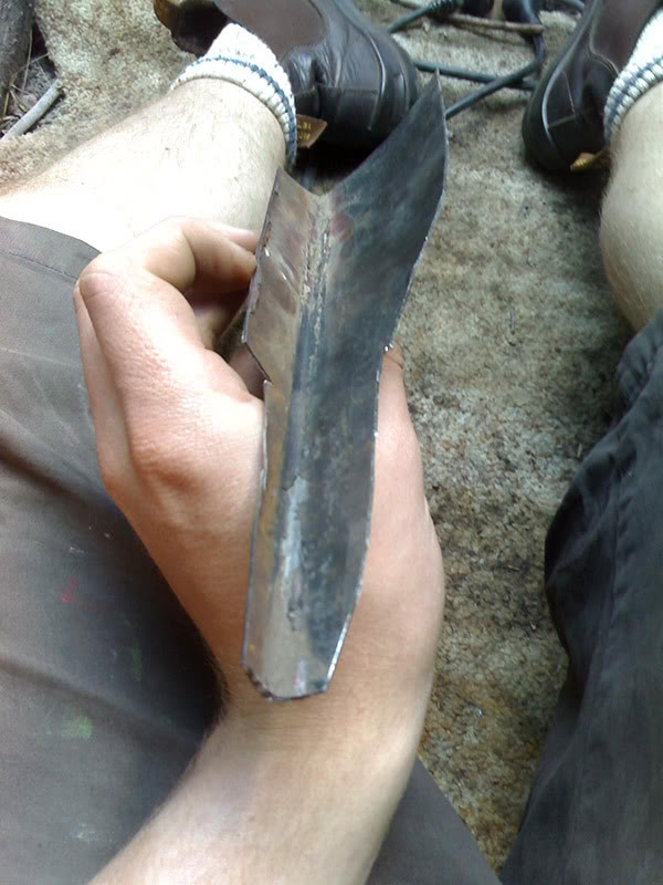

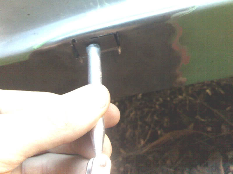

I borrowed a welder from a mate, it's a little mig with one of those disposable bottles on the side, I don't want to use his overpriced gas so I just put some gasless wire in it and it's working alright, I'll just replace the wire I use when I give it back, and I'm doing some small rust repairs on his KE70 instead of paying him to rent it. Sweet

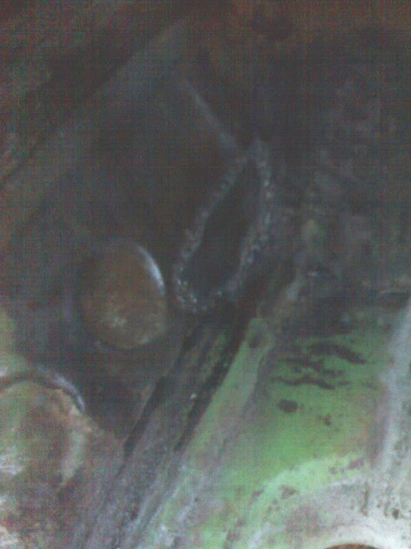

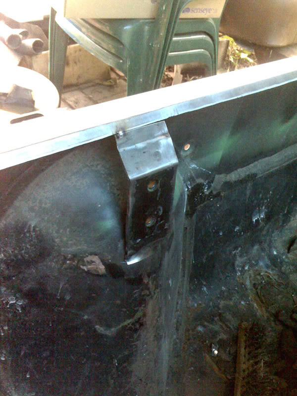

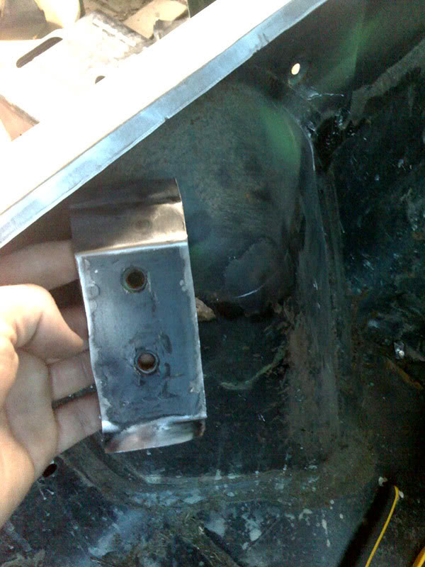

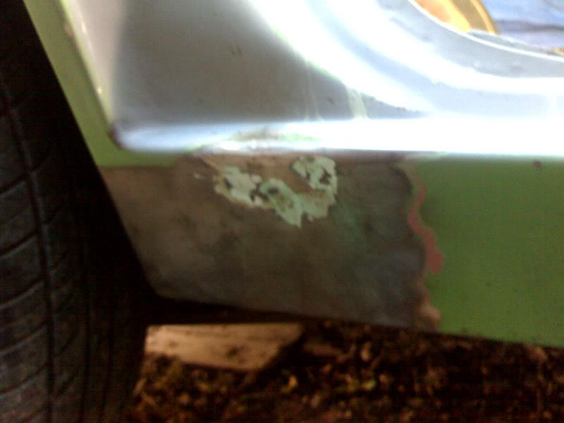

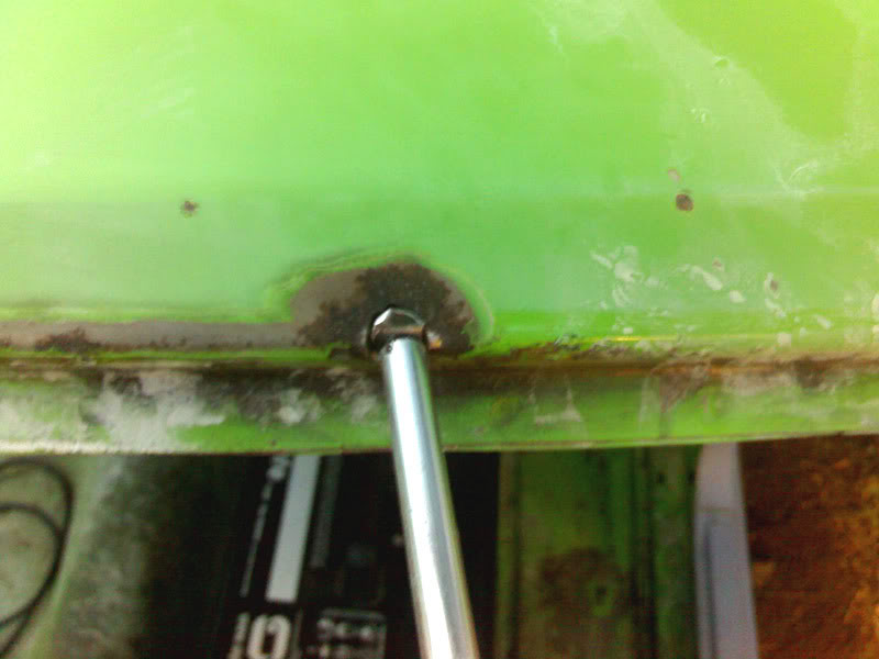

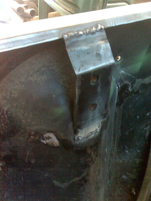

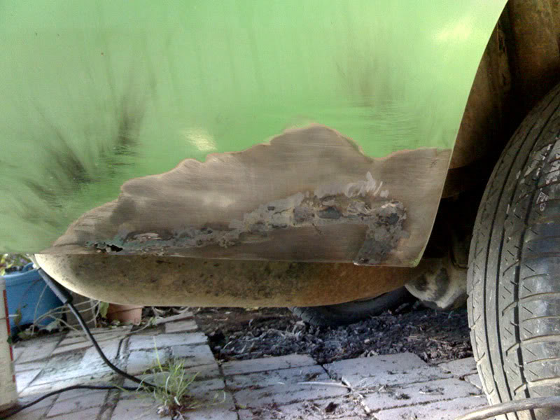

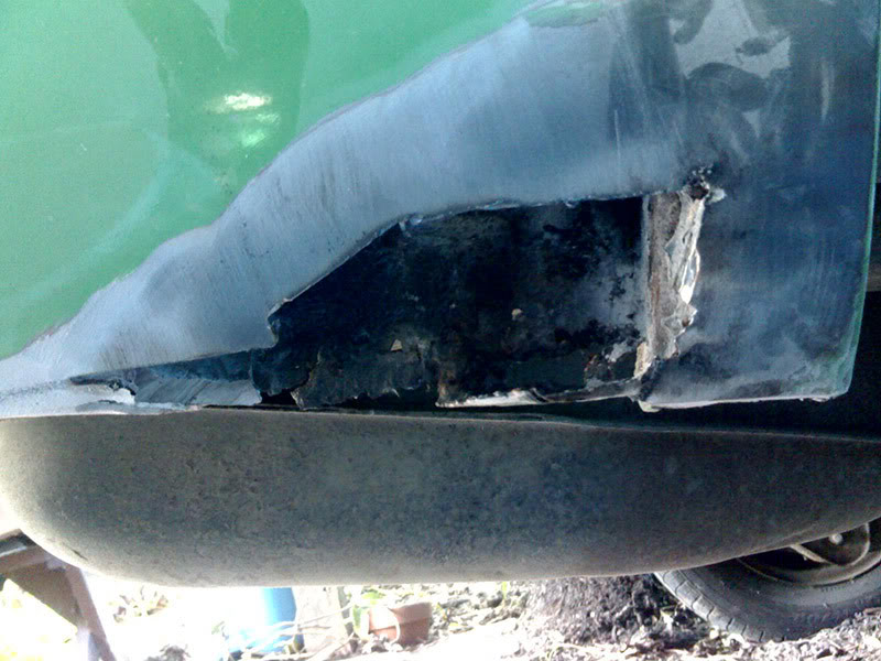

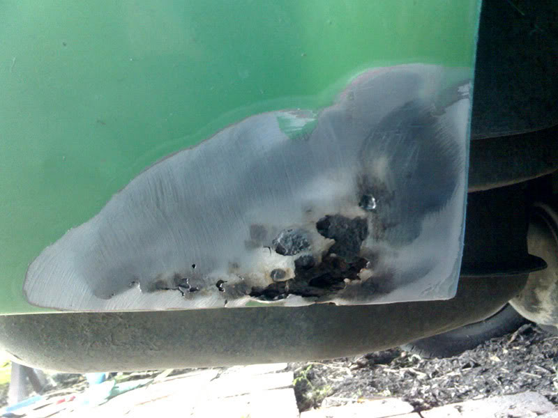

Did a few repairs today, none of them are too flash but progress is progress, I would probably be taking a lot more care if the car was on a rotissery, but it won't run as is and I can't even really jack it up properly on soft dirt, so some of my working positions are really awkward/uncomfortable and hense the repairs are a bit rushed.
Bit of weight reduction lol

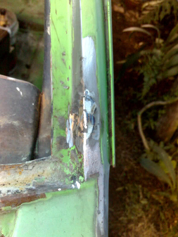

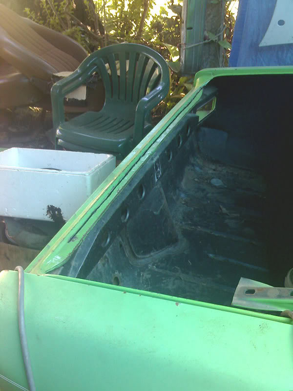

More little window surround rust spots, just ground out most of the rust and bent up a little piece to weld in there, not the best way of doing it but the most appropriate and convenient :P

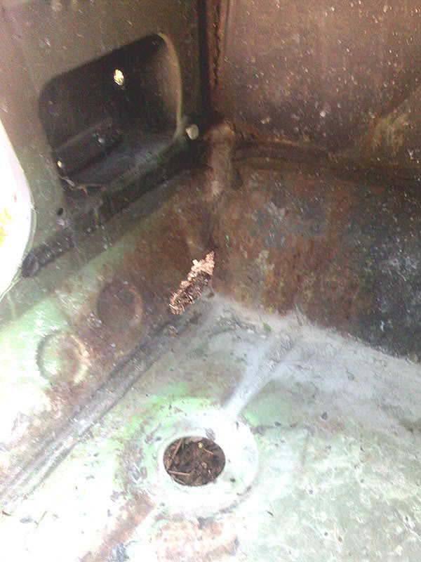

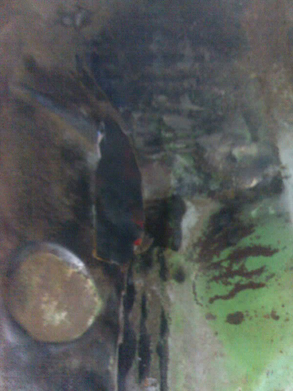

Rust in footwell, got a bit of rust I have to do separately underneath this one as well

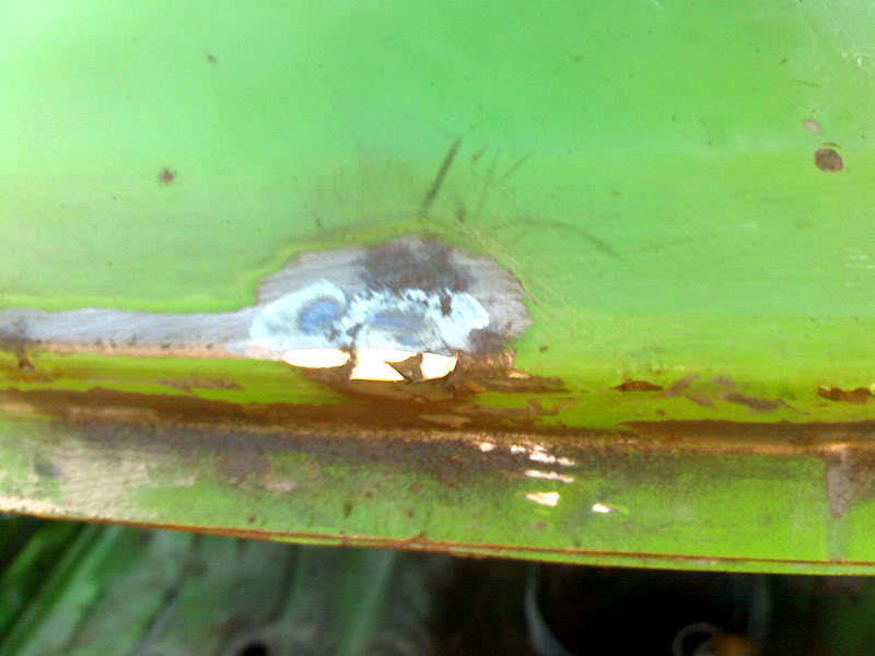

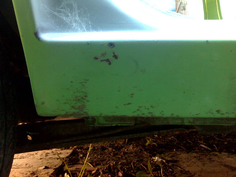

Few pin holes in the sill, RHS here, LHS is a bit worse.

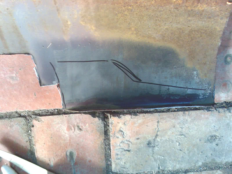

Posted 23 January 2010 - 06:42 PM
One more repair down... almost. Will finish it off tomorrow
