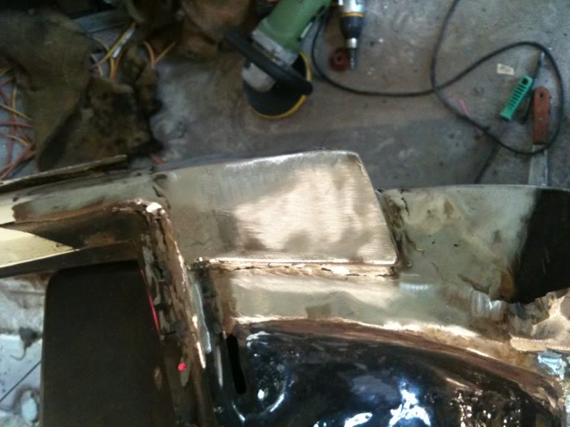

Finished my A-Pillars, just have to grind a bit in the channel with a die grinder.

Nice work. Those sections look almost factory

Hey cheers Mick! Alot of trial and error... Luck and flukes as well. The A pillar base sections are relatively easy to make, I made a thread about it in Fabrication.

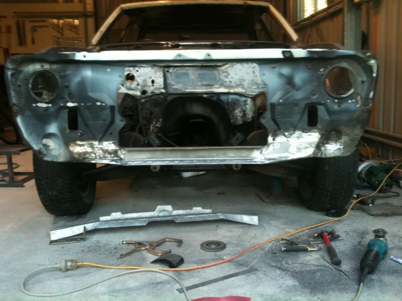

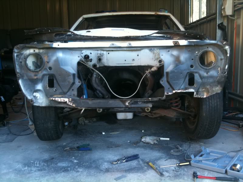

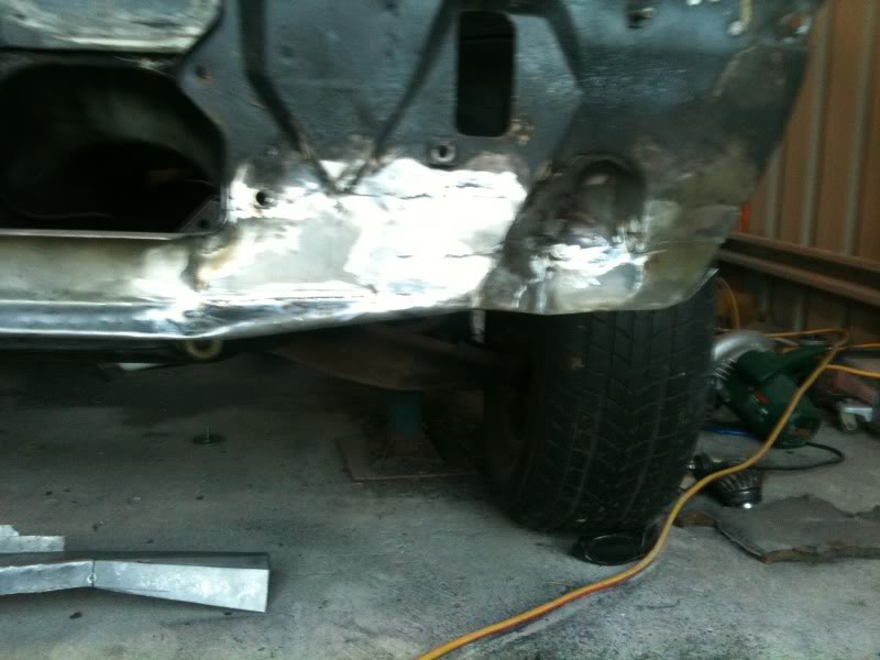

I have been busy lately and finally got stuck into a section I didn't think I could do... The radiator support section.
This is what I started with.

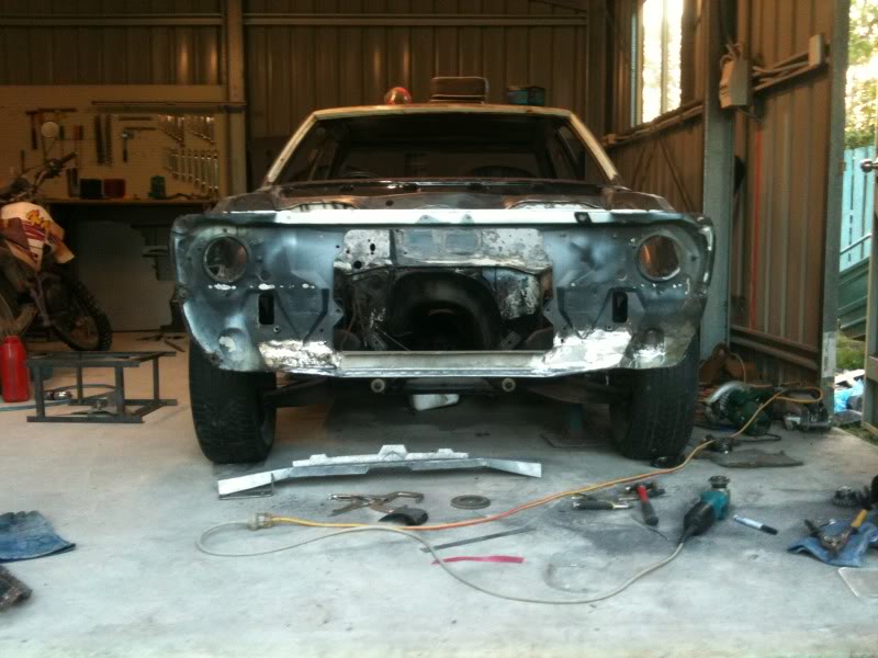

Cut off and welded in some filler basically till i can put the proper shape across, buts its hard without a guide, so it will do til the support panel is finished.

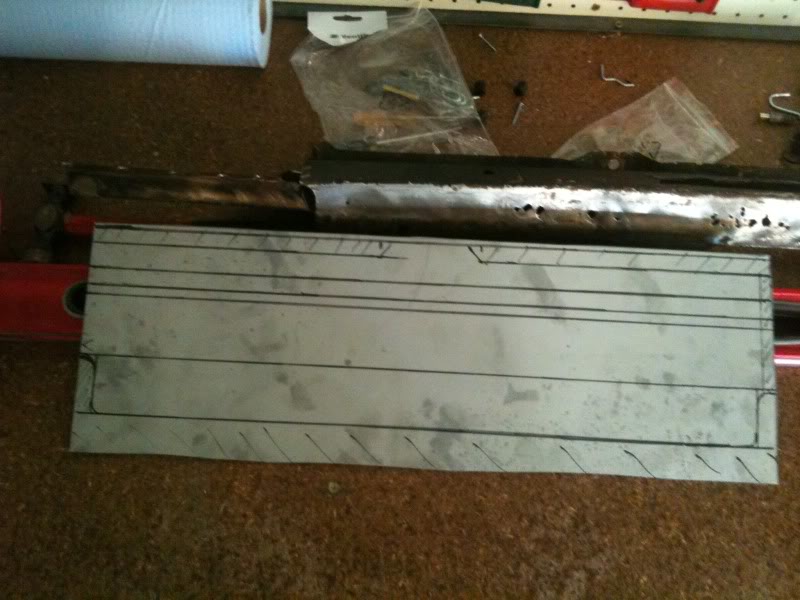

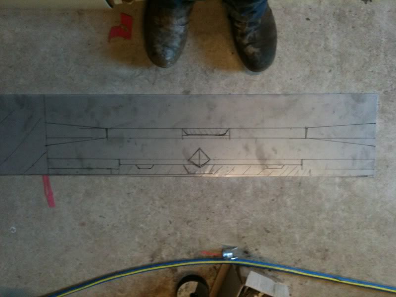

Measured up and drew up some plans.

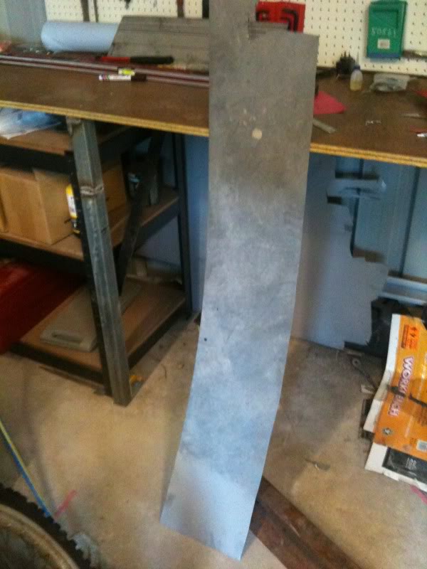

Cut out some steel and put the measurements across to the steel.

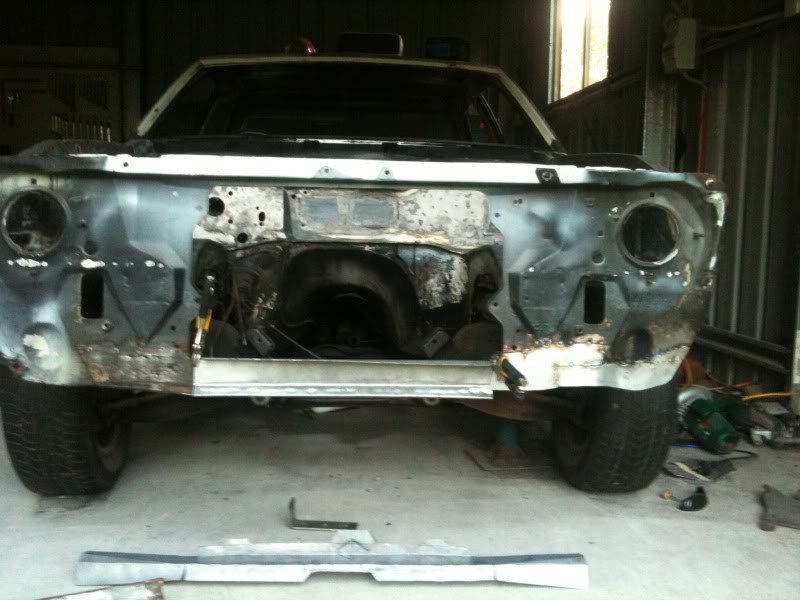

Bent up into shape and in position for a trial fit...
Turns out it fitted up pretty well, a bit of minor tweaking was required but all in all worked out well. To be welded up properly this week.

Cheers Lee, I thought I'd put all the measurements up in case someone else wanted to use them for their own project. A Panbrake would make this alot easier. I just had the old clamp down to solid bit of steel and bash it into shape haha.

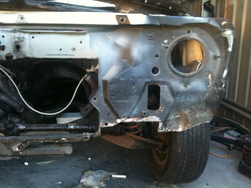

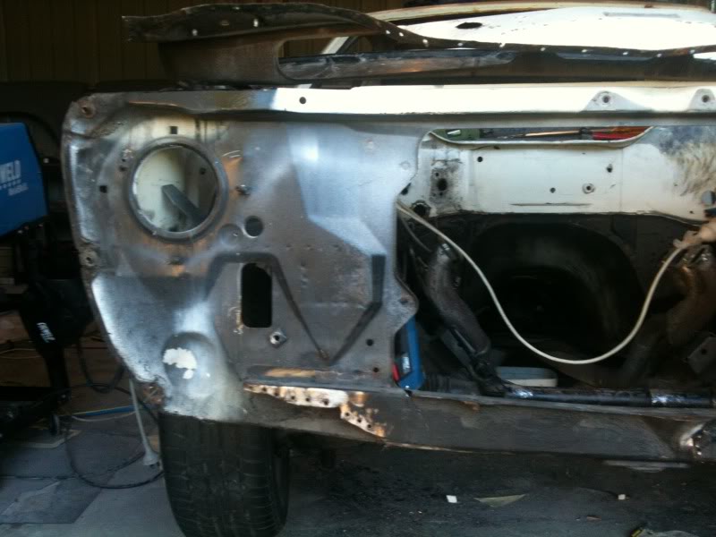

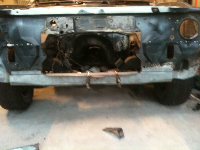

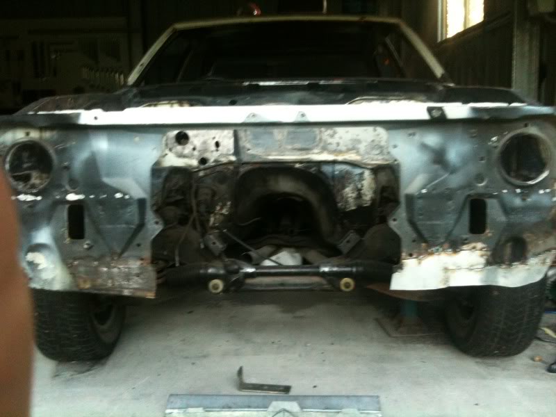

Front Apron finished, Rad support panel to go on tomorrow.
Now just gotta put the quarter on to guage where the hole will need to be drilled.

Thats bloody brilliant work mate! I tried viewing the measurements but it came out a bit blurry so could possibly email the attachment to me?
[email protected]
Much appreciated, thanks! :spoton:

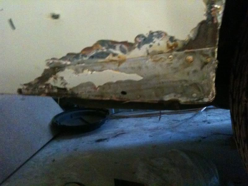

Have also been fixing some rust holes in the hinge recess where it has rusted due to the A pillar rusting out and dripping water into the trap. Will post pictures tomorrow.

Finished off my front Rad Support and Apron. Didn't get pictures though... (Doh!) Next time.

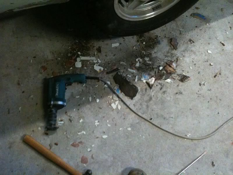

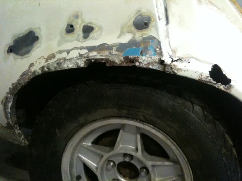

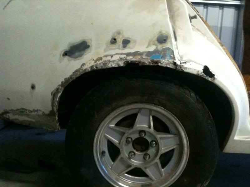

As per DJ's instructions, began attacking the bog filled areas in the Rear 1/4's to save $$$ at blasters.... Only got a chance to strip one off... The reason being...
That centre where the structural pillar runs down to the arch has actually rusted away and I took the photos before removing the bog. Found plenty of rivets too.
Heres the Bog removed about 50% completed.
Other 1/4 / Arch tomorrow.
Some of those pieces by the way were almost 40 mm thick.
