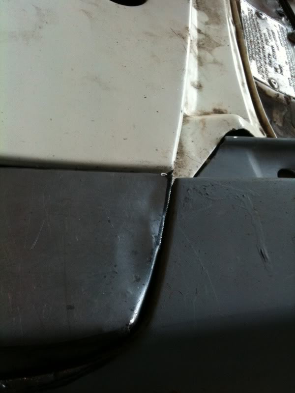

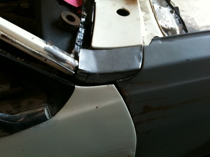

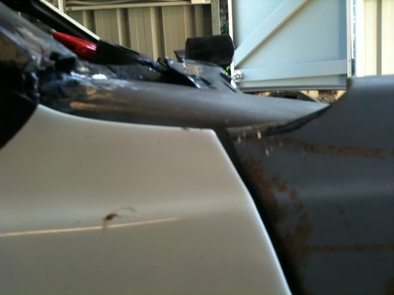

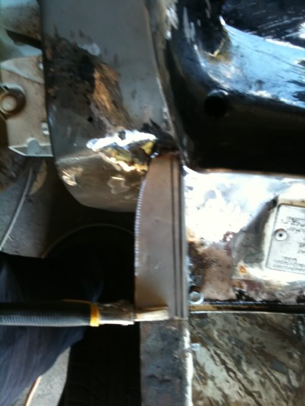

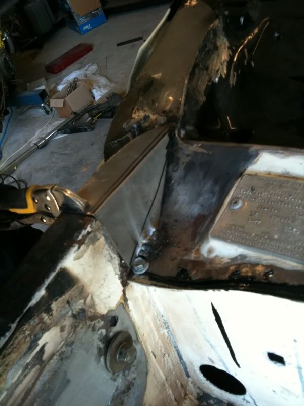

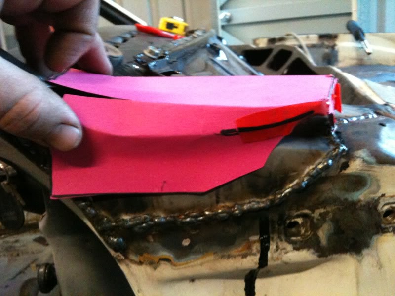

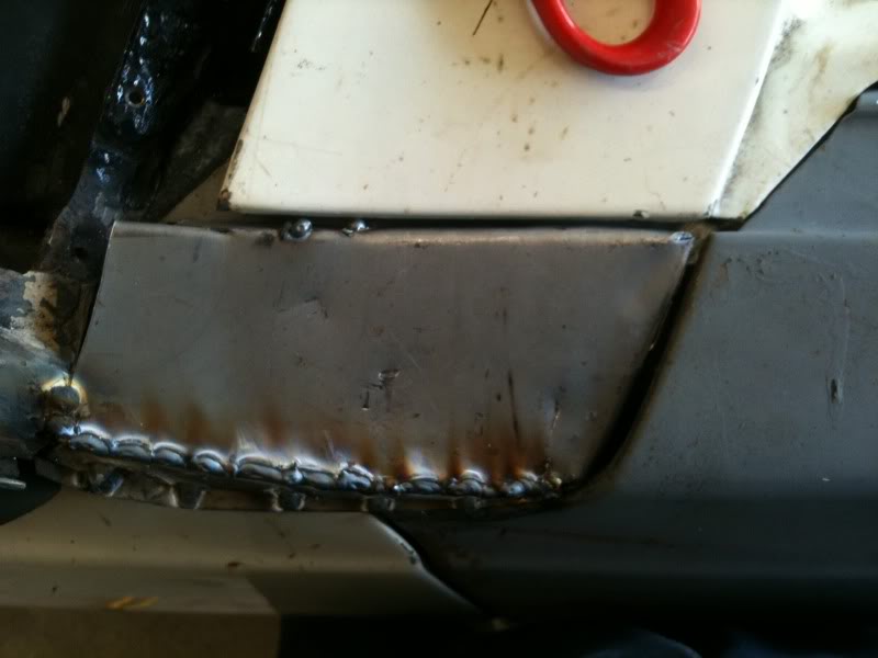

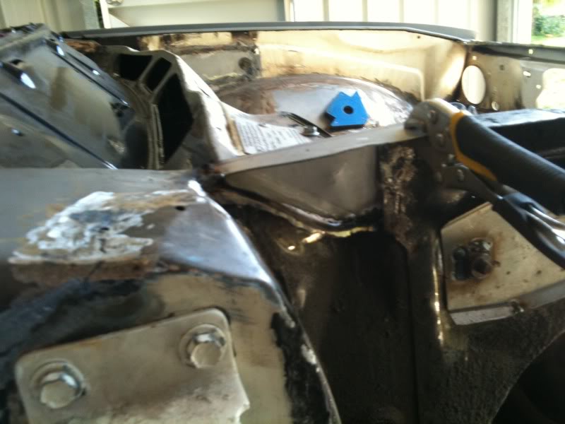

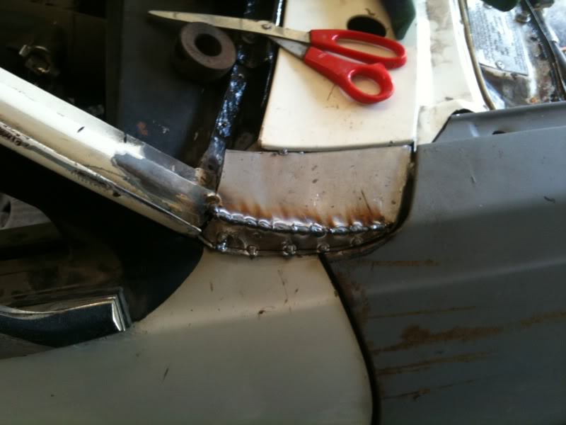

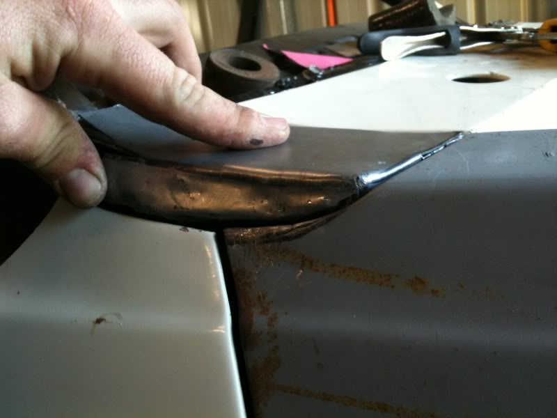

Hey fellas had a few hours on the Torry today, so here is the quick update of what I did.
Made a piece to go from the guard to the A pillar for the hanging 1/4 to bolt to. (Did that even make sense?)
Welded it on.

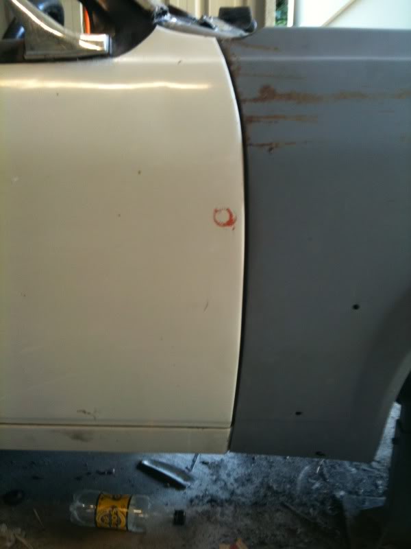

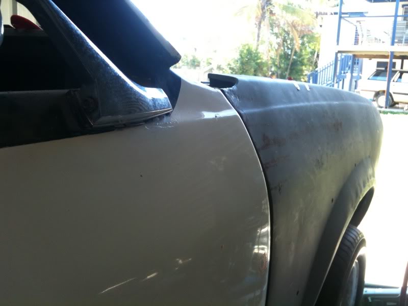

Hung the 1/4 to see how it sits, I also had to trim the 1/4 as the curve was not continuous.
This is the result of the trim.
Nice even panel gap too...
AND the panel crease lines up too which is magnificent lol.

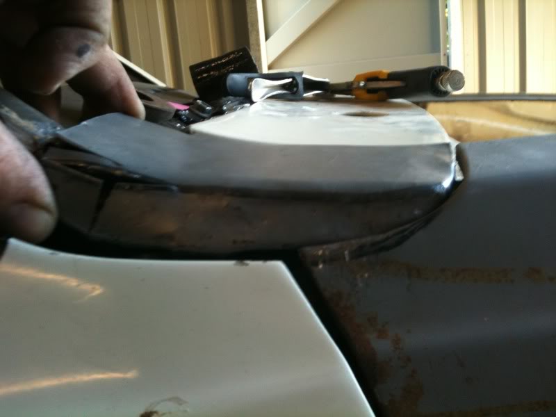

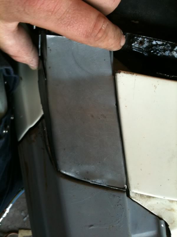

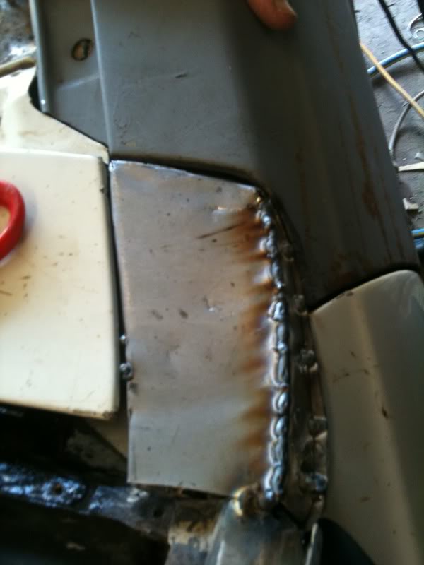

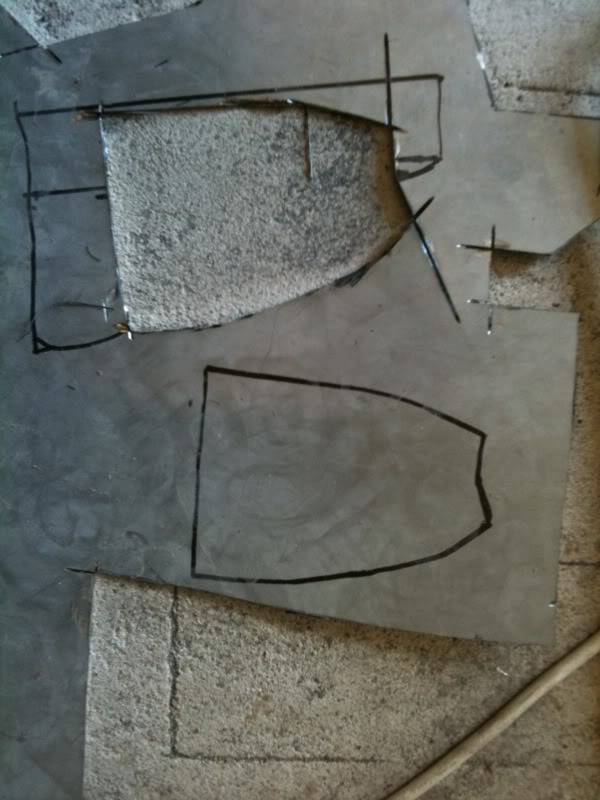

I then used this cardboard template to make the hard bit.
Metal cut out. Folded into shape and then caressed (manhandled/snipped/bashed/folded) into place. Didn't turn out as bad as I thought it would... Ignore the gaps and creases I can fix that.
So that's it today, tack it on tomorrow and start the other side, hopefully will be pretty straightforward... Can't do anymore today cos I have to study for my trade certificate exam on Wednesday. Hope you enjoy it.

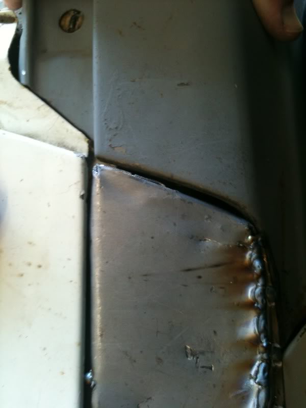

Posted 01 September 2011 - 03:53 PM
Well just a quick update, I've made up both sides now, just gotta finish the welding and grind it back to get the shapes right etc...
Turned out OK... I can handle them not being 100%. I can settle for 95% correct haha.
